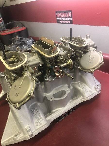

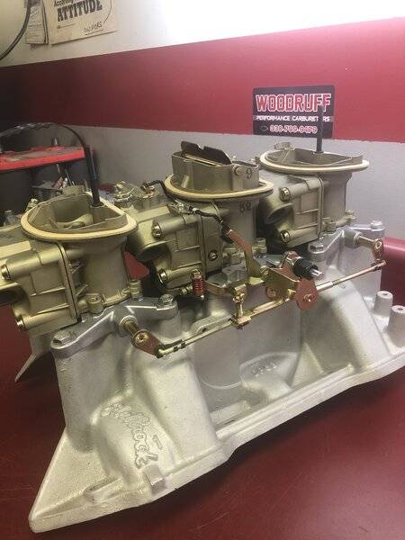

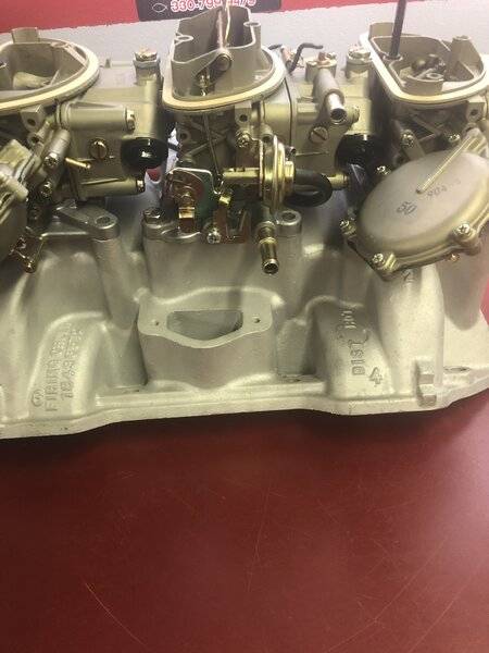

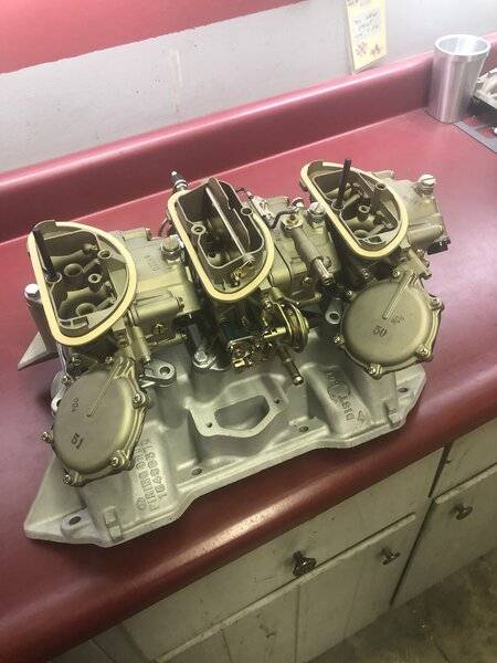

Dave can you tell me about turn around time and do you run them?
At the moment my turnaround is 8 weeks . Yes, everything is pressure tested and test run. I have a 358” motor hooked to a power glide with a trans brake, which makes it possible to test under a load. It also has an O2 sensor plumbed in, to monitor AFR throughout its functions. Since those pics, I have had my local decal shop make me the little white rectangular stickers for the vacuum pod. That is where one of the ink stamps belongs.
