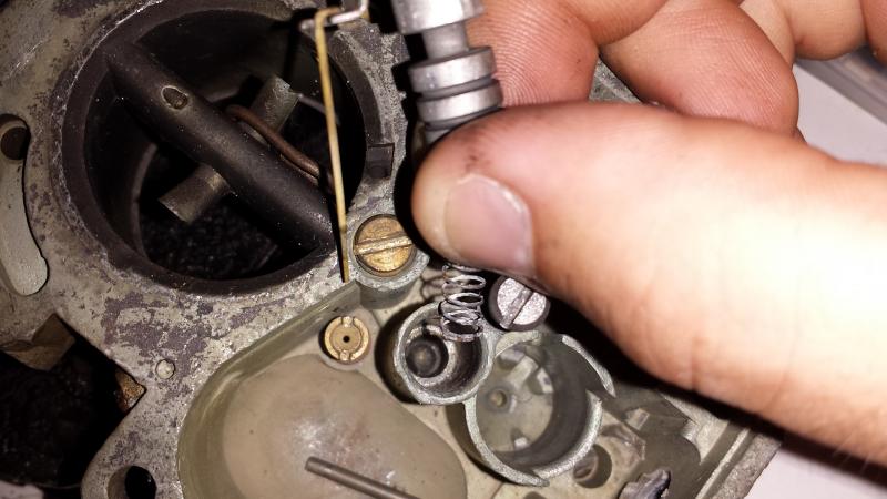

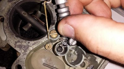

After adjusting and playing with fuel mixture screw and no results, I figured I would check the "quality of build" the remanufactured carb came with. After disassembly, I noticed the float looked as if it had been stepped on. I then took it upon myself to take the float from the old carb and without adjusting it, installed it into the new carb. I also decided to swap the metering jet. The old had a 130 jet and the new came with a 160 jet. I have an idea of how these operate and figured since the carbs were the same, I'd put what I knew worked into the new carb. The new carb is currently using the old 130 jet.

Hi miller. I'm pretty sure the carb is clean. However, I noticed that the pump that adjusts the metering jet height had a corroded spring underneath. It was also missing the small "bb" that I guess should have been under the spring. I took the "bb" from the old one and dropped it in there and put the metering pump back in place. I figured it would be ok since the carbs are the same. I'm not the best with carburetors, I just try to do my best.
That 'BB' is important. It is a check valve and without it, carb will definitely have problems. Make certain the one is under the Accelerator pump as well.

I have a feeling that the little "bb" that goes in the bottom of the finger size cylinder below the metering jet pump could be causing an issue? It fits into a little hole under the spring. The old carb had it in there and the new one was missing it. Maybe the new carb was designed slightly different? I have had it apart maybe 15 times already. This pic is of the old carb to give an idea. What would a "bb" be in there for? 20141001_135349.jpg

'bb' or check-balls are generally in there to act as a one way valve.

Hey guys, the check ball that I added to the rebuilt carb's jet pump had been causing the problem (I removed it). I also noticed that the old carb actually had a place for the check ball to rest in the bottom. The new one allowed the ball to roll into the hole with little resistance.
