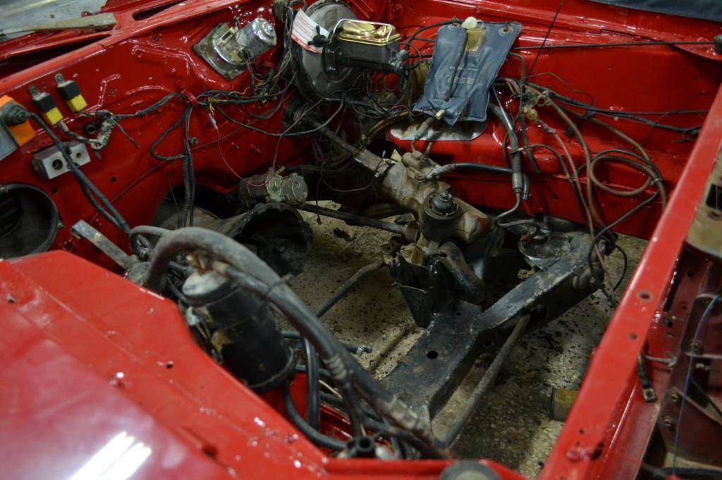

hey ive got a 440/4speed on my 73 roadrunner
it was originally a slant 6 ..now its got a bb k member in it(had it in when i bought the car
there's a slight slant on the engine(front to back)
the carbs slight slanted down??is this the way it should be?
what would cause this?

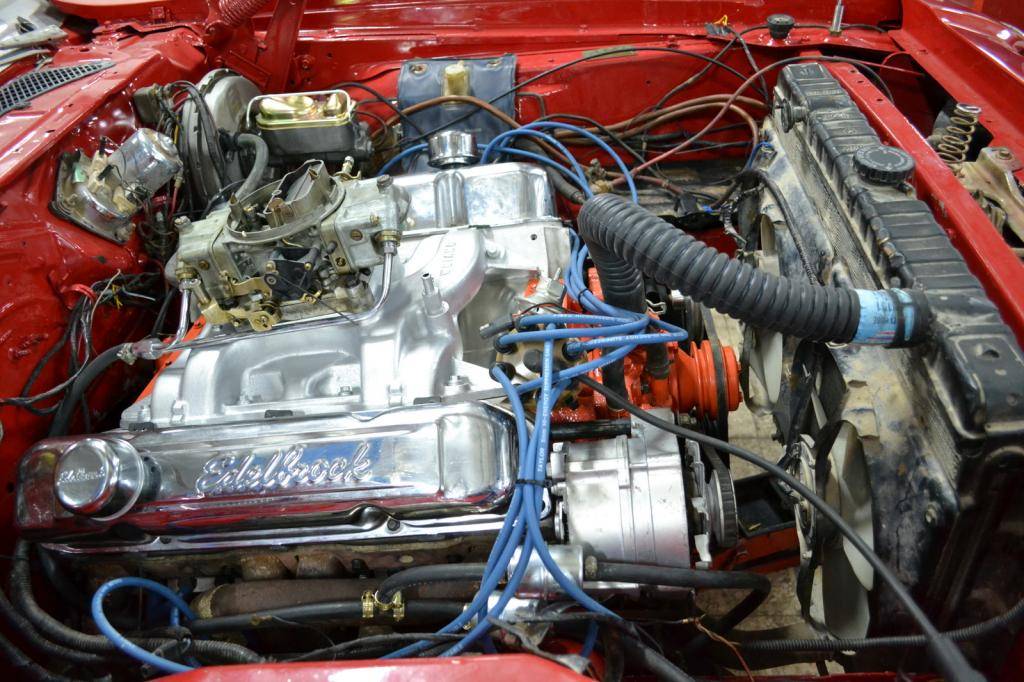

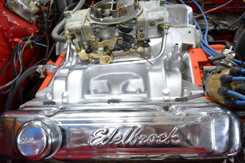

****...i think ur right oo man im stopid....could this have done any damage to my engine?ive ran about 200 miles after the rebuild
the intake is on backwards
changing up the intake today....hope this fixes the slant
it took me a moment to spot it but the power brake fitting kinda seals the deal!
taking the intake off today hopefuoll this solves it...if not here another 2 weeks for intake gaskets

dude you seriously need to get that rubber fuel line off of and away from the headers and turn the carb fuel line around facing the front. im sorry man , but that is some mickey mouse work right there and that car is going to burn to the ground if you dont straighten it out. the fuel pump is in front , not the back of the engine and over the headers ...........just sayin man
