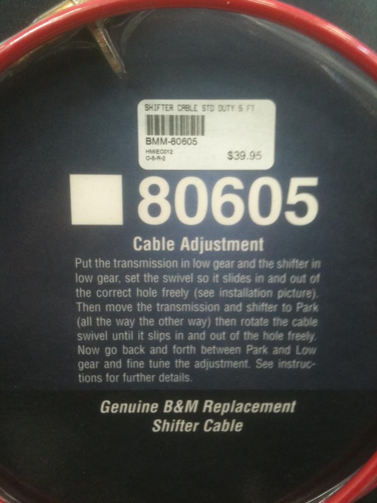

My assumption is you have a B&M???? ANyways, I had same problem with mine, so when I was walking by the cable one day in Summit, I snapped a photo - worked for me
Thanks Cazbah, but this is the original slap stick shifter I am having problems with, it is the
short linkage rod that goes from the arm through the tunnel, to the tranny lever, it has a bolt adjustment on it to slide the rod in and out, I can't find the right spot.
