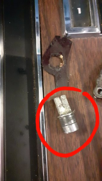

Had to drill out a broken screw for my turn signal leveler and destroyed this threaded sleave that holds the screw and goes up against the turnsignal switch. Where can I get a new one and what are they called?
You need a new turn signal switch. That part is made into the switch and pilots into the hole on the columns collar.
