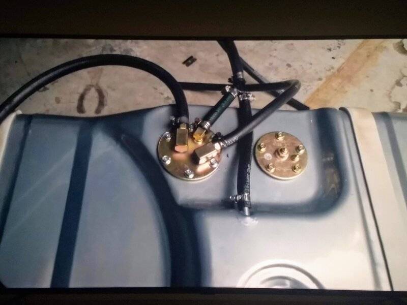

Here's how they plumbed my Holley/Tanks Inc in the El Camino. It's a pic of a different car since I don't have one of mine before it was installed.
