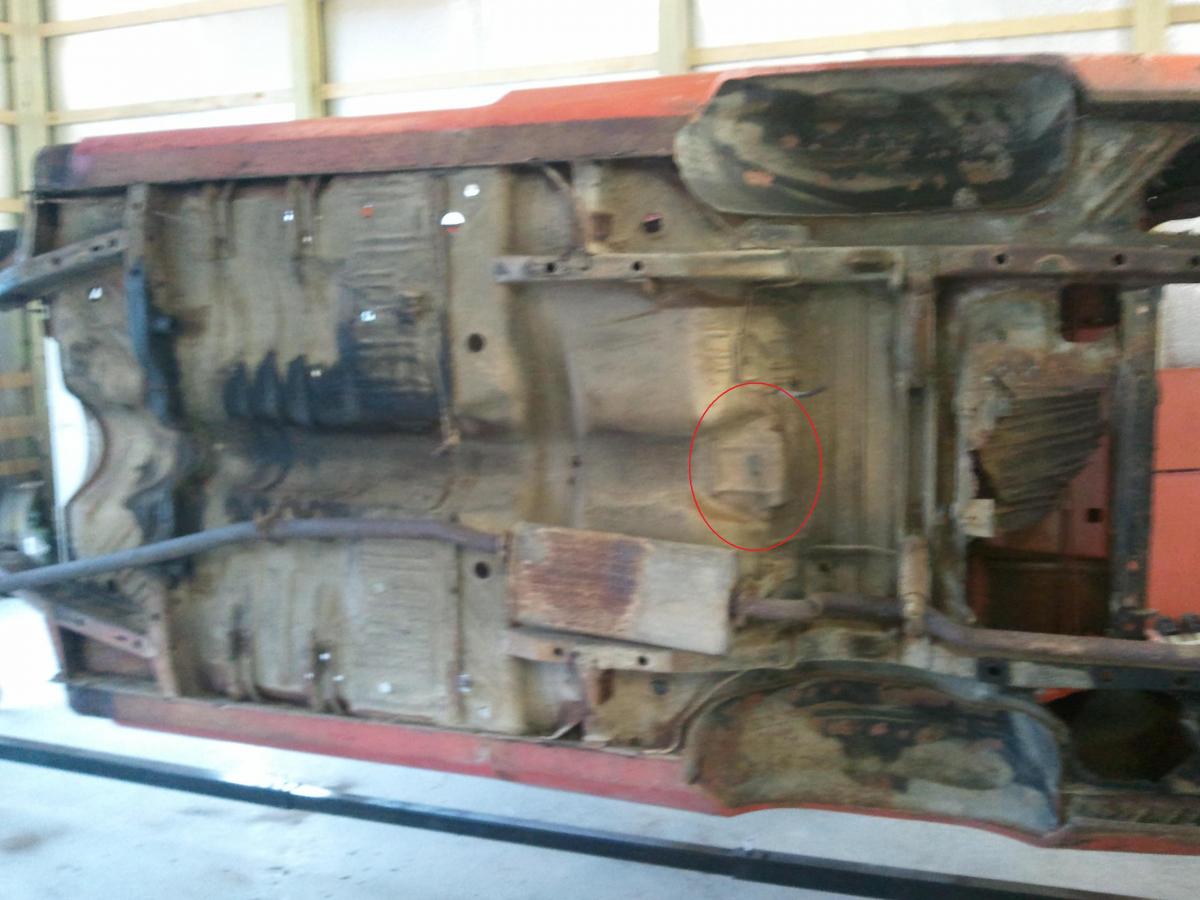

your 69 Roadrunner has the pinion snubber plate (unless its rusted off!!)
my 69 Charger has one I will post a pic, I have a couple pics of my Charger on the rotiserre so you can get a good view, Hemi cars had re-enforced spring hanger area.

Thanks man!! I looked tonight and I damn sure do have one.
