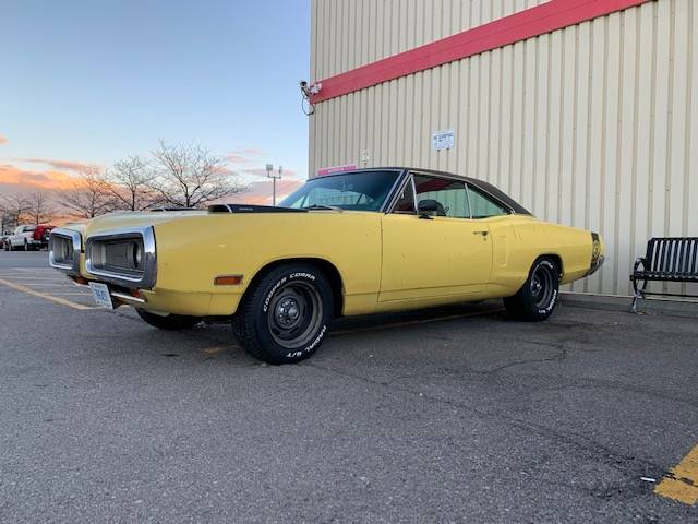

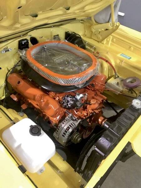

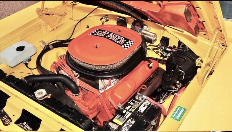

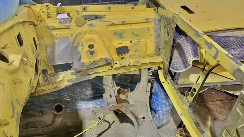

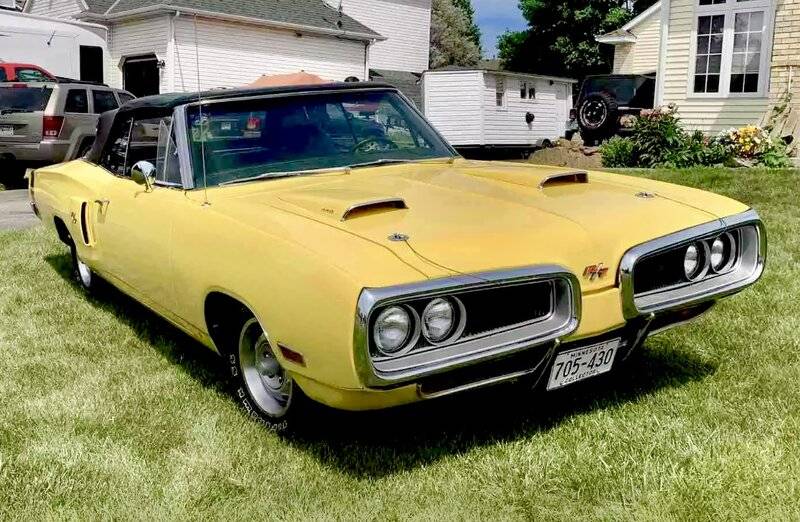

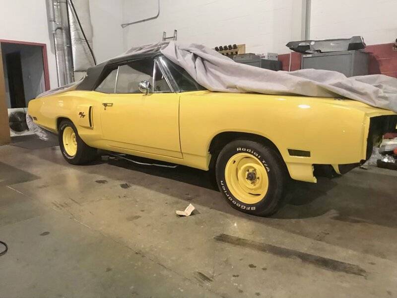

It nice to read about so many other “Nostril Lovers” or should i say “Nostril Pickers”, cause Im one too. I must say I’m truly surprised because when i first joined and made inquiries, my car didnt get love due to the Nostrils and i was told i was a fool for putting more money to restore it.
The money is spent and i get it back on Nov. 29th. I changed to 15” color match steel wheels and redline centercaps. Added a date correct six-pack to tge stock 440 and had it bored and stroked .55 over. Then I freshened up the 4-speed and the Dana rearend, placed front drums with date coded factory disc and restored front/rear suspension. Only need spring to drop the top and cruise
Not sure why it didn't get love - it's a great car!

Great looking car, congrats.

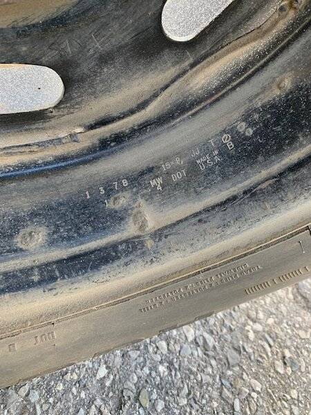

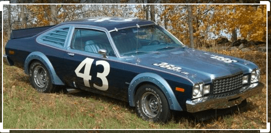

Nice. Did it come with those wheels? They look like the Volare/Aspen kit car wheels.
Also was it a factory air car? unusual to see fully tinted windows otherwise.
Thanks, yes came w/ the wheels, I have the thin chrome trim rings too.
Here's a photo of the info inside the wheel, any help identifying is appreciated.
No air cond. but the glass seems to be original. Don't know much about the car as there is no fender tag.
Yep, 1978 date code 15X8 wheels will be the kit car wheels. Hard to see in the pictures but there should be no nubs to hold a hub cap on. Those are pretty rare.
