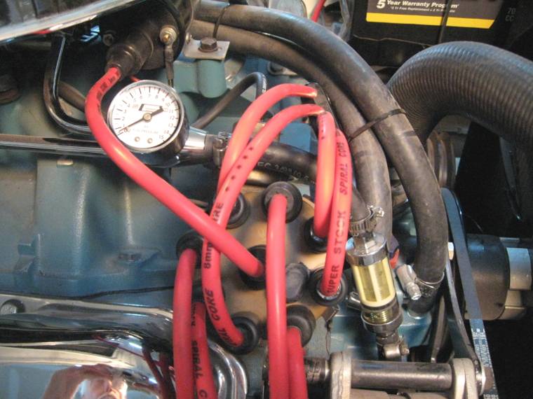

First thing I did was to install a fuel pressure gauge so I could tell what kind of pressure the electric pump would put out while pushing fuel through the mechanical pump. The answer was 6-7 psi. More than enough needed.

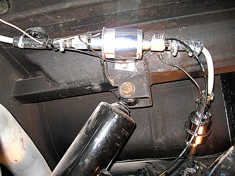

The pump was installed just above the right side shock mount. You can see the outlet is higher than the inlet. Plus I also installed a filter between the pump and the tank as recommended by Airtex. If that cross-member looks a little different than yours its because I added a 2x2 .120 wall square steel cross-member between the frame rails to strengthen that area because I'm running air shocks.... but that's another story.
