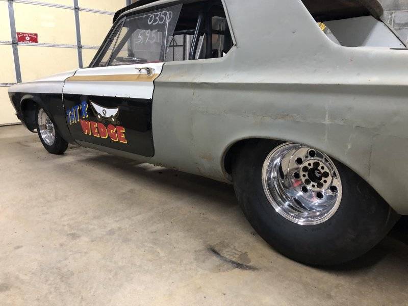

This is the 63 Plymouth it’s going in. Not a recent pic but it’s the only one I have on my phone.

Hey! I know that car! That was Jimmy Fullers car! I raced against him when it had an all aluminum big inch wedge.
I don’t think this is the same car. This is a new build that was started by someone that passed away a few years ago. The fenders and doors are off the car you are referring to though. It’s still racing in NSS. The chassis was built for this one and that’s about as far as it got before he passed. I am finishing it up. This car is a tube chassis four link car. Should be a nice piece when finished.
Well thanks. So the doors and fenders I recognized. ruffcut
