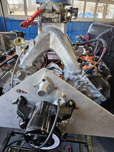

The engine is on the run stand. Working on this new stuff is a bit different for me. Sorting through sensors to get spark.
I finally have it figured out and hope to have it running this week.

I’d say that working on the new stuff would be challenging for the majority of us. That’s quite the intake. What kind of weight difference is there from the RB set up.

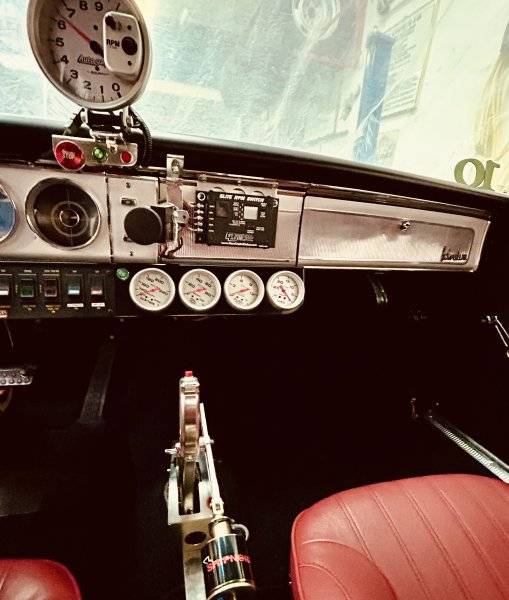

I think so long as you’re using the push buttons there’s no way to add either air or electric shift that I can think of. For my quarter stick shifter, electric was the only kit available for it. I’m looking forward to this upgrade.
I don't think there's going to be much weight savings.
If you compare a 440 with aluminum heads, intake, waterpump etc., probably about the same.

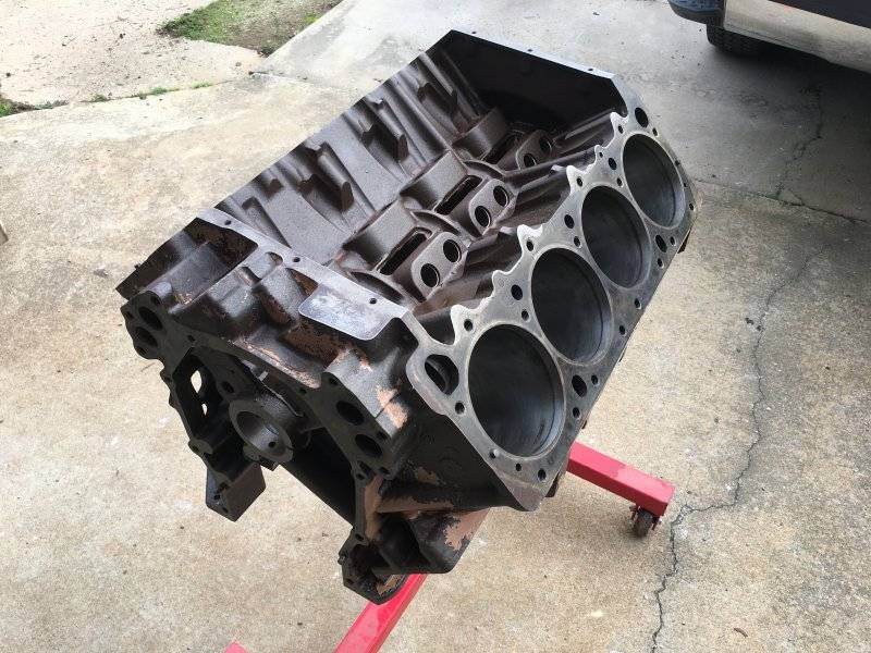

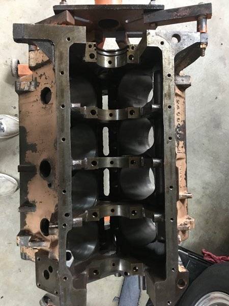

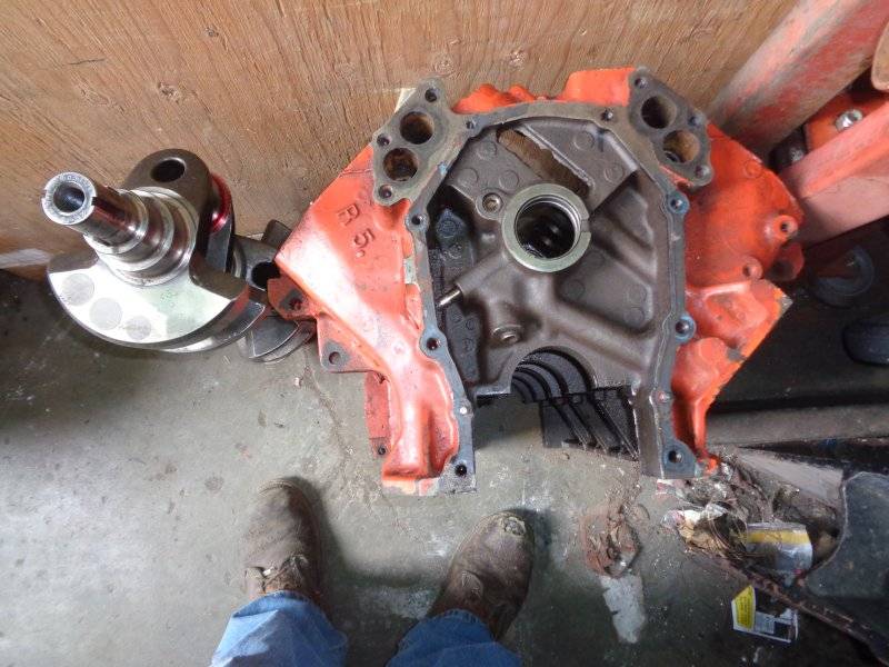

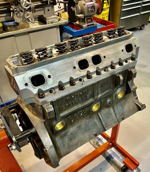

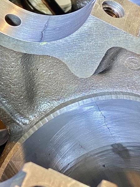

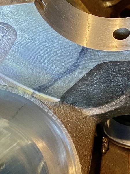

So this is the time of year when lots of us guys have hibernated into the garage and get to working on their off-season list. My list had a number of items, one being engine refresh, which is the last one on my list. Originally built in 2015, it was time for my 505. Coming apart everything looked excellent and it seemed like nothing but a new set of rings, brgs, timing set and cylinder heads touch up. I did find one lifter that was iffy also so a new set will also go in. Upon further clean up and close inspection though, what the hell, #2 main web has a crack leading down into the bottoms of 1 & 3 cylinders. This crack could have been in the making for years, there was no signs of a problem. The old girl was dipping into the 9.’s last time out and not missing a beat. Regardless, things just took a turn for the worse.
Just like I’ve heard here many times from many people those stock RB blocks will crack once the HP gets up there. Not IF but WHEN. So coming across this was not that much of a surprise. Even with Aluminum main caps, main stud girdle and a lightweight crank. Oh well.
Last time out.

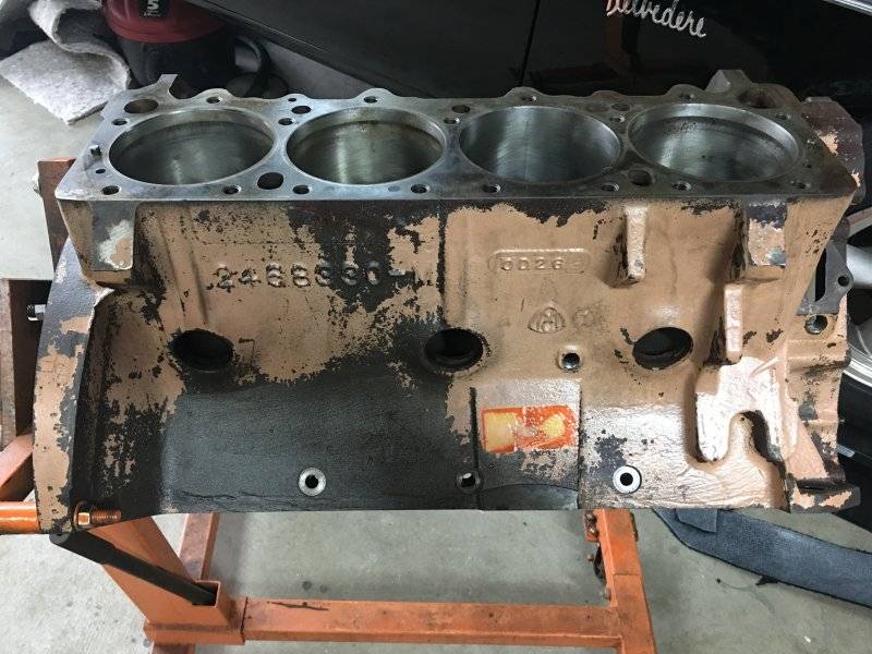

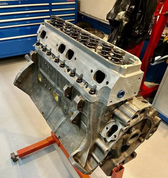

I’ve always said that when the 505 dies It’ll be time for a 540, aftermarket block on pump gas. Mancini has blocks for 5,999.00, shipping included within the US. Then. A Buddy says to me. I have an RB block. It’s been sitting for 40 years - use it. A couple days later the block showed up at my place and a new plan got underway.

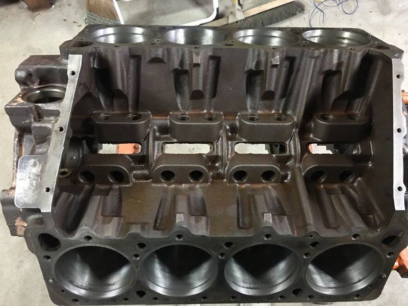

Block cleaned up. Water jackets got the Muriatic Acid treatment and a partial Hard Blok fill is complete. Block is now out for bore, line hone with main studs, decking, etc. The 540 pump gas plan got moved back to the next time around. That would have likely opened a new can of worms anyways, with the old Plymouth limited to 10.00 as it sits now. If this Round 2 505 lasts 9 years like the first one did, holy smokes the age number..

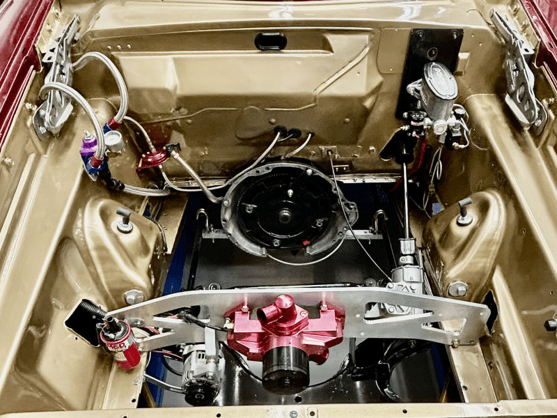

But the rest of the list is wrapped up. And I did end up finding 53lbs, all of it off the front - glass hood included. Although the HardBlok put some Lbs back in. Will still meet my 3200Lb less driver with fuel target.
Tidied up electrical and some other areas. Was eyeing the firewall reinforcement plate, but it dodged the cut for now.
Steering column got very lighter.
Electric shift addition for ‘24.

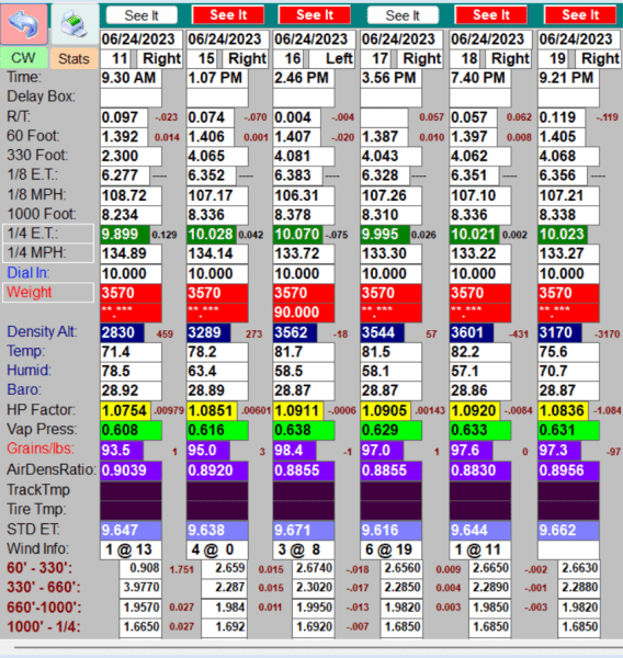

Nice car/combo! Yes it's pretty much 'when' at big power levels. What was the total weight at the line? Did you have a crank trigger on it?
Thanks for the kind words. Weight was 3440-3445 on the staring line with me in the car. Yes a crank trigger was added for the 2023 season.
santa came again today !
say hello to my little friend....P5007482AB.
That's showing about 700HP...very nice! What's the combo? Is it detailed elsewhere here? How many years did you sort things out? How many laps? I think you could see that I was eluding that a crank trigger is one component helpful to longevity?
Dyno was 720HP, 677 TQ. 326 passes on the motor. 505.
12.7 CR. Edelbrock Victor MW heads. Solid Roller, Super Victor & 1050 Dom.
Always ran at 36 degrees timing except this last season once the trigger was installed, running it at 34-35 degrees. Timing got rock solid with the addition of the trigger.
Replacement block will have a partial fill. Same rotating assembly freshened. Both car and driver has been a fun work in progress and always improving.
Use to work for SCAT SALES/ENGINE TECH. Sometimes a crank with center counterweights can stop web cracks. It affects the middle 3 usually. Your firing order 18436572 has 4/3 firing on the same main. If there was even the slightest bit of crossover spark in the cap then 3 would fire way soon. Just throwing a few ideas into the mix.
Yes yes excellent point! I have a 4/7 3/2 swap cam and I'm sure that's another aid for longevity. I looked a while back but did not notice SCAT carrying a line of 8 CW cranks for BBMopar.
