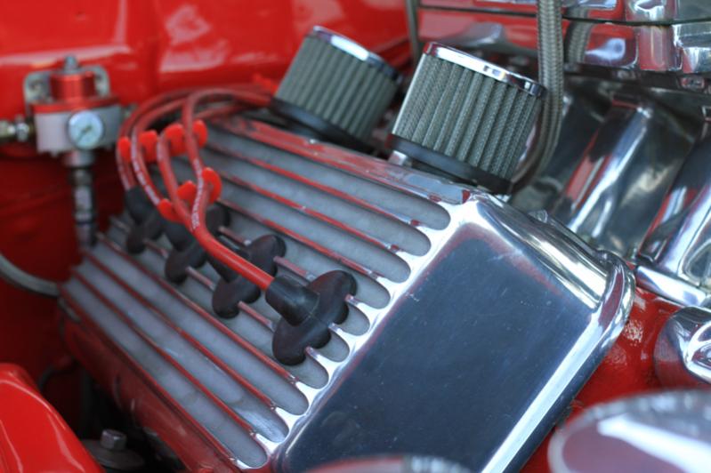

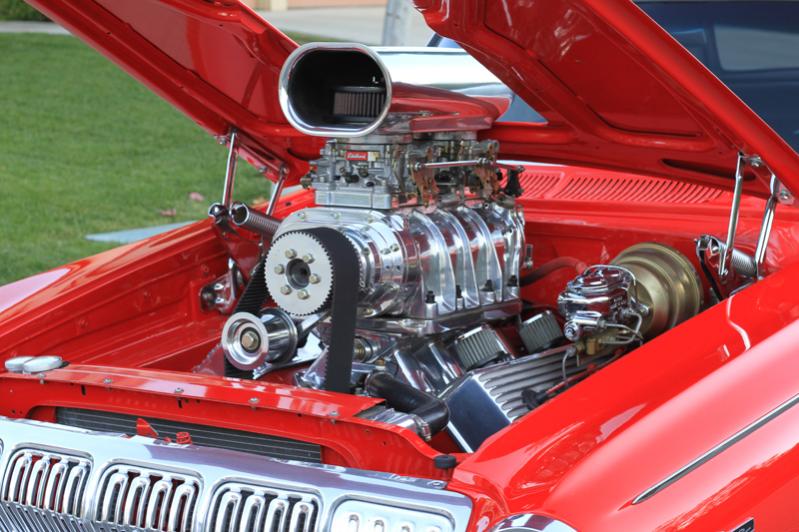

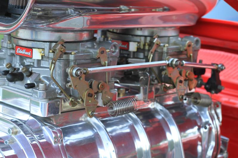

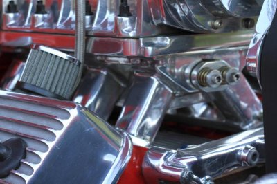

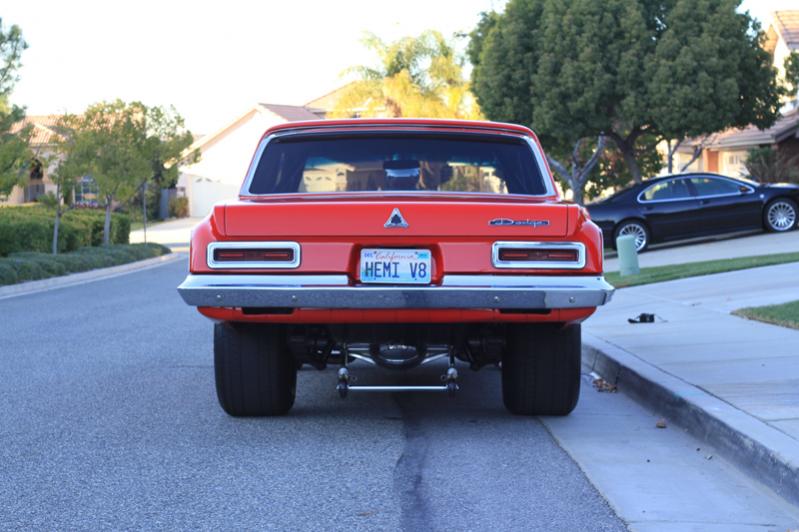

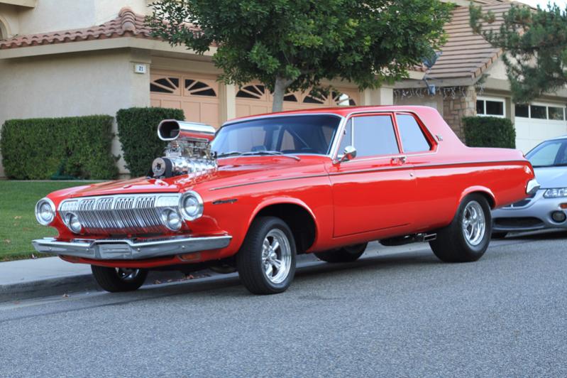

Some photos of my 1963 Dodge 330 Hemi
speedchangesyou
7:45 AM
Apr 13, 2012
302
224
Southern California
1963 Dodge Hemi 330
Complete Rotisserie Restoration
Built by “The Street Rod Factory”
ENGINE
1958 Chrysler 392 Block Bored .30 to 398 Cubic Inches
Keith Black Blower Pistons, ARP Rod Bolts
Double Keyed Steel Crank & Balancer
Comp Cam Hydraulic Roller Cam and Lifters
Adjustable Rockers
Mallory Ignition
Milodon Hemi High Pressure Oil Pump
Mancini Racing H.T. Power Master XS
The Blower Shop 871 Blower
Edelbrock 659 Carbs
Holly 140 Gpm Electric Fuel Pump
EXHAUST
Borla Pro XS Series
DMH Borla XS Pro Series Electric Cut Outs
TRANSMISSION
Tremec 5 Speed manual
Clutch Cernterforce 10 ½”
Hurst Shifter
COOLING
Griffin HP Series 4 Core Aluminum
Integrated Walker Fan & Shroud Assembly
BODY
1963 Dodge 330
Entire car, undercarriage, floors, roof, Trunk bead blasted and blocked sanded taken down to the metal, this is an original NO RUST California Car.
All bright work, windows, every single piece of chrome or aluminum replaced with NOS stock
After being bead blasted and sanded the undercarriage was undercoated with 3m Dynatron Dynapro Paintable rubbererized 544
PAINT
2006 Ditzler PPG Doge Viper RED
DIFFERENTIAL
Currie Polished Aluminum 58” 3.70 Posi, with Currie 31 Spline Axles
WHEELS & TIRES
Front Wheels Torgue Thrust 2, 15x6
Rear Wheels Torque Thrust 2 15x12
BRAKES
4-wheel disc power assist.​
