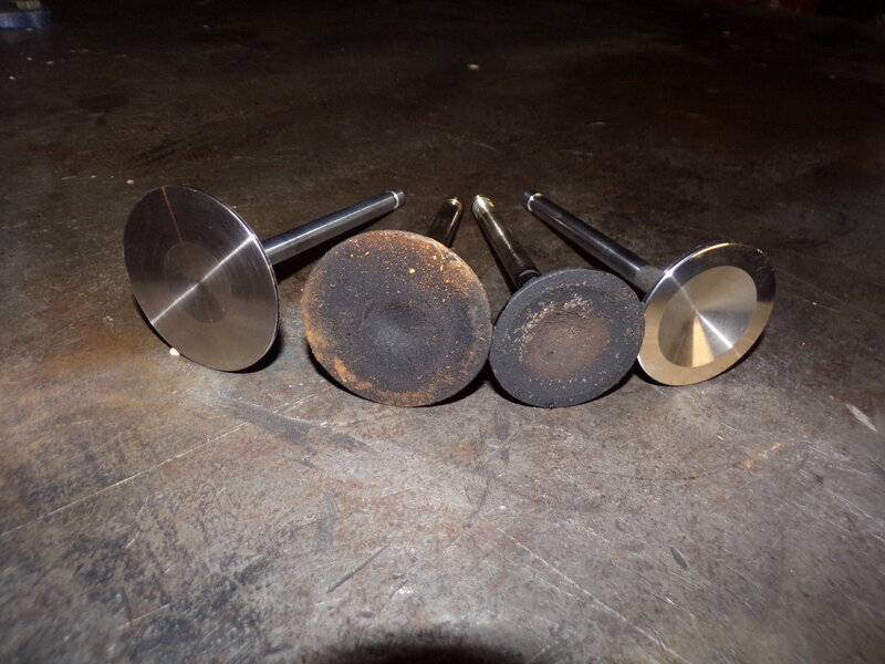

There was an order mistake about 12 years ago and I never found a place for these 11/32 stem 2.20/1.84 valves. Looks like they have a home finally. Here they are along side the 2.08/1.74 valves that came out of the heads.
