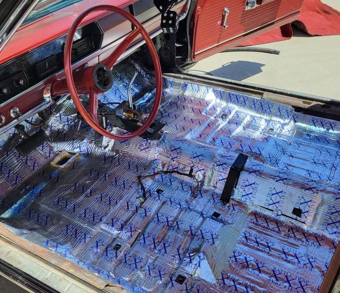

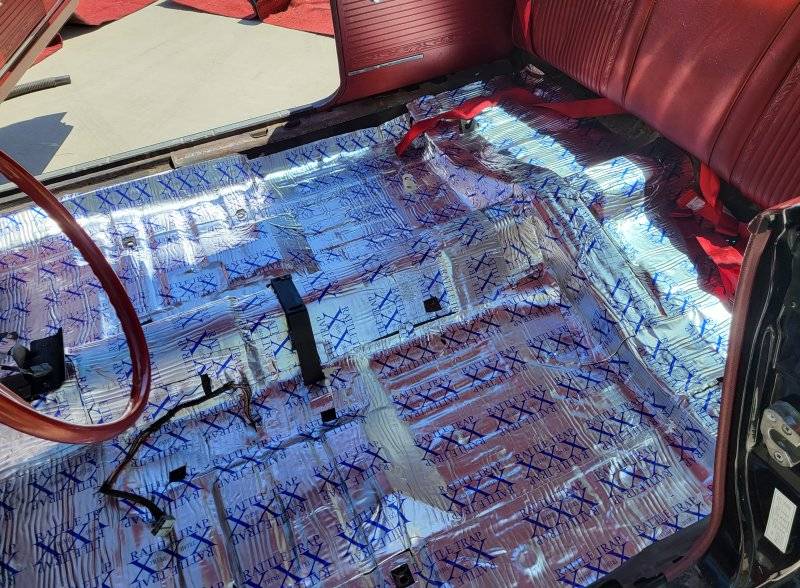

Sure does. I recently put A/C in my old bomb.Thermo-Tec 14610 acoustical + heat control mat.
I only did the firewall but will do the rest of the floor when I re- carpet.

I just did my satellite a few months back for heat protection. So it's just on the Floorplans and the bottom side of the console.
But I've done other cars on the insides of the doors . And it makes a huge difference in how the doors sound
