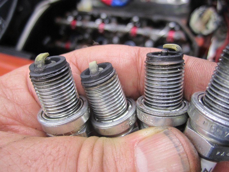

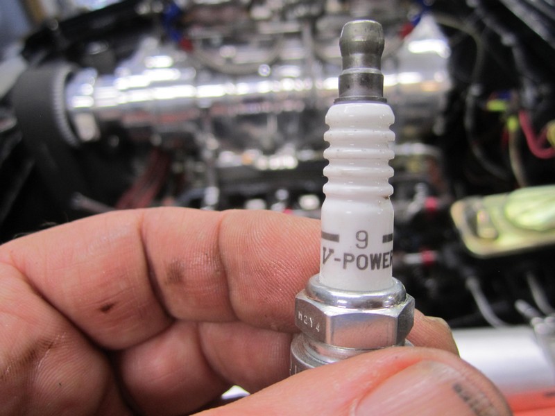

I use NGK 8's.They are $20 a set.Street driven gapped at .35,making a pass just cleans 'em nice. I have a large collection of 7's,8's,9's and even tried 10's. Some of these plugs only have 3 passes on them. I'm a tuna fish chasing an E/T.
