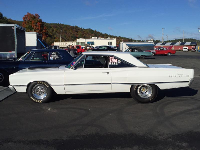

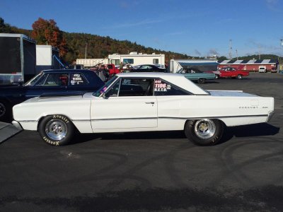

IMG_0273.jpgimage.jpgIve run NGK R5672A-8 STK #7173 in my cars for 10 years gapped at 35 with an MSD 6A and a 7AL2 as of late. I have the current set in for 2 years now as I take them out check the gap and when put back in the car doesn't change one bit. Indy 440EZ heads with Max Wedge ports. Best of 9.88 with the Belvedere and 9.75 just scratching the surface on the Coronet
