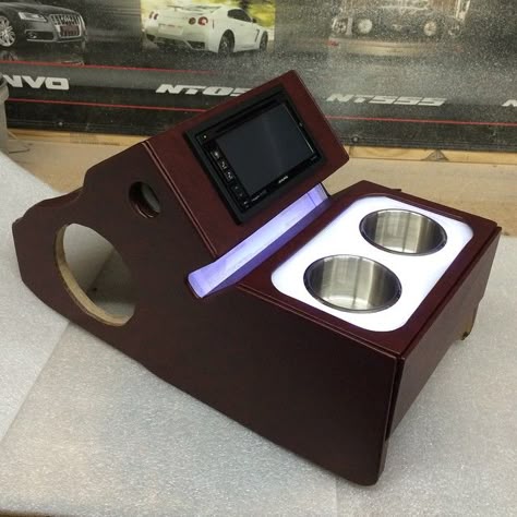

Why not build a custom console that fits under the dash and the you can put whatever size you want in there, as well as the head unit and even an amp.
