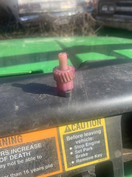

Is there a chart for gear ratio teeth on the 64 trans, I have an 18 tooth, not sure what is was for, rear long gone so can’t check ratio. /6 3 speed manual trans.
Thanks
Thanks

Once you figure out what gear you need start a WTB add on here. More than likely a member will have one.

Good question. It might be the total height of the gear itself. All I know is you just install them and they work.
Some of the higher rear gear ratios do require an adapter.
Great, looks like I’ll need the adapter and 19-20-21 to start.big question, where does that adapter go? My cable is a solid rig right into trans unlike the later that screws on.
What? I didn't think they were changable due to not being able to adjust the distance from the tailshaft gear? I need a 17 tooth then... my speedo is like 80 at 40 right now..
