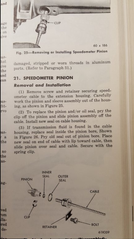

If it's the '64 and earlier trans., here is what's in the service manual. I don't see how it can be installed too far.

the trans is a '69 904 so it goes in just like any other later cable. i don't have any kinks in it. it could be to long though and binding inside the cover. it is routed just like the original cable so it's pretty smooth. i think i will shorten it by about 1/4" or so and see what happens. if you look up anybody that sells them for this year, theirs are to short. mine is 72" and theirs are 62". this is measured by the length of the outer cover. i don't see how theirs could be used. it would surely kink if used. thanks for the replies.
