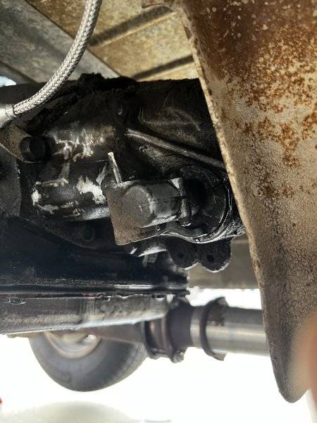

On the lower end you have something screwed on to it. What does the attachment point look like at the transmission? Pictures. Might be from a reduction box. This cable should work. Are you sure on the year? PIONEER CA3056
I hadn't even thought of that, but it's a whole different type of speedo drive then I am used to. When I get to work on it again (probably next week) I'll see if I can get that little piece out of the bottom of the old cable. In the meantime here is a quick picture of what I've got at the transmission end
Thank you again. If that piece just came out with the old cable then I'd think I should be able to remove it, screw it back in the box pictured above and get that CA3056 and I should be set.
That is a speedometer gear reduction box. Put some grease in the box and put the threaded part back into it. If you run it with the wheels off the ground putting it in gear it should be spinning . If so you are good there. The CA3056 should work.
