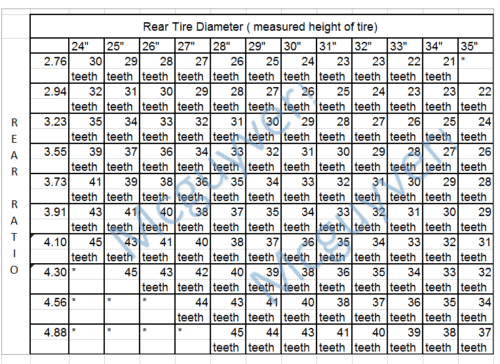

Believe i am looking for the following gears. there for my TCI Modified Trans (727) Gear ratio - my street gear- is 4.10's a green 39 tooth for the 30" tires and a red 36 tooth for the 28" tires. thanks Jerry Horn will go down and check to see what I have if anyone needs something. Will add to this later as to what is here. Jerry Horn
Am in process of pulling trans. ( on back in home shop). Flex plate oops! will find out what gear is actually in trans, now so I am sure which one I need. Will get back to all once I know. Thanks
You may need to look up on different charts for the proper gear. The chart I just looked at said a 36 tooth for 30" tires and a 38 tooth for 28" tires. Makes sense that the gear for taller tires has less teeth.
Ya and if ya use a calculator it's 38.5 or 39.3. So I called Layson (as they support us) and ordered a 36 and a 39 Thanks everyone
