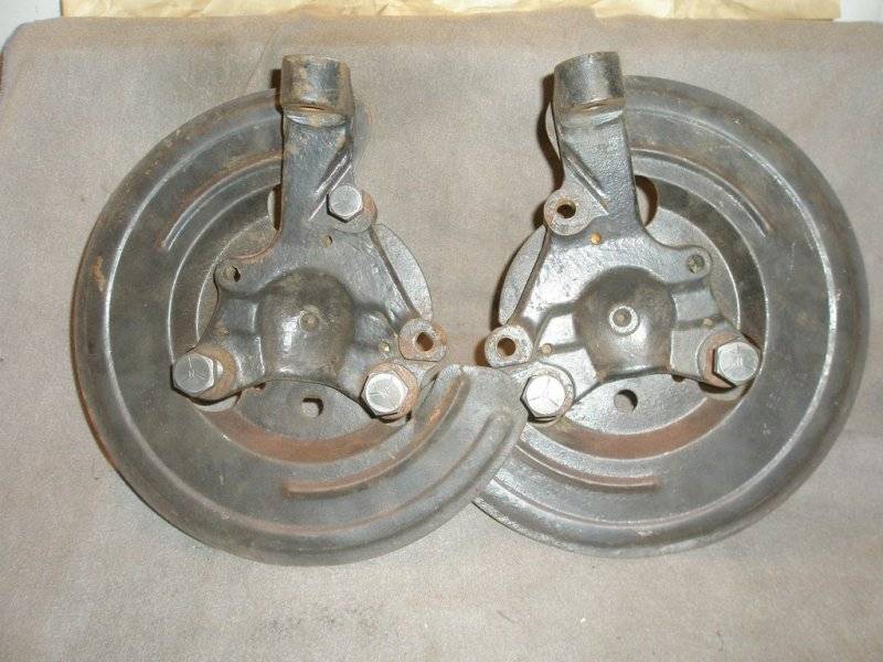

These are the spindles that were on my 67 GTX
I thought that the bolts slide through the front side of the spindle, through the lower ball joint and were secured with a castle nut.
But mine are threaded - so the nut would have to come through the back side and thread into the spindle.
Is this the way it should be???
I am stumped
( I was not there when the body shop dismantled the car so I didn’t see the original set up)
Not sure. All I have seen had a nut. Those look to be disc brake spindles.
Those are not spindles, they are steering knuckles. It does look like it is for a disc brake application.

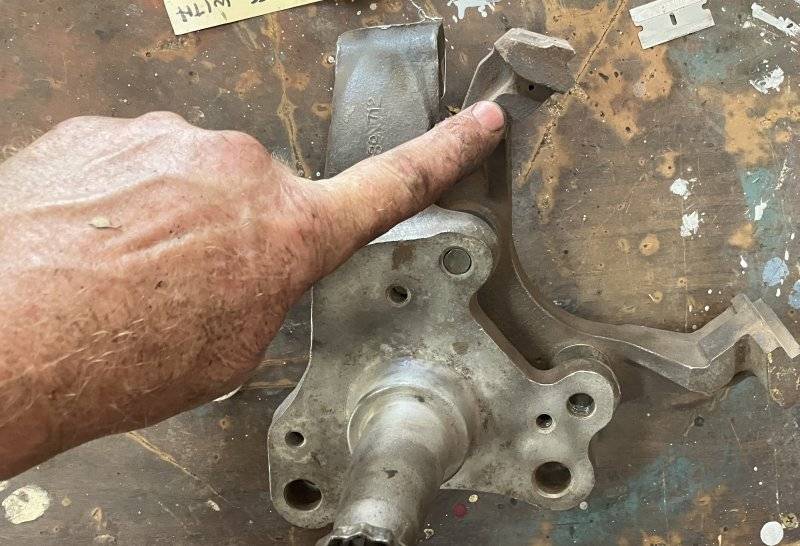

We all are entitled to our opinion but are not entitled to our own facts.
THIS is a steering knuckle.

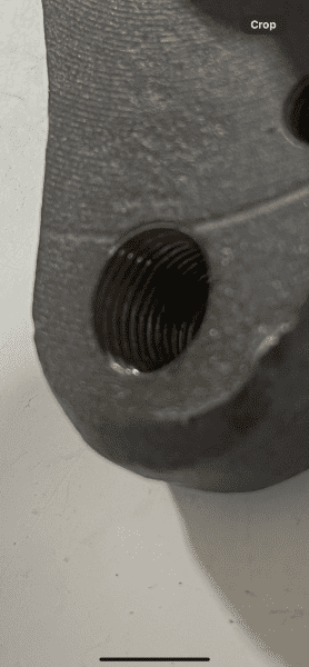

It is a single piece forging . Here is another part of the knuckle.

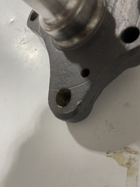

Below is a removable caliper mounting bracket.

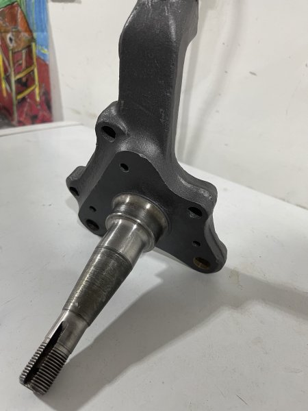

THIS is the only part of all of this that is a spindle.
To call everything between the ball joints a “spindle” is wrong.
