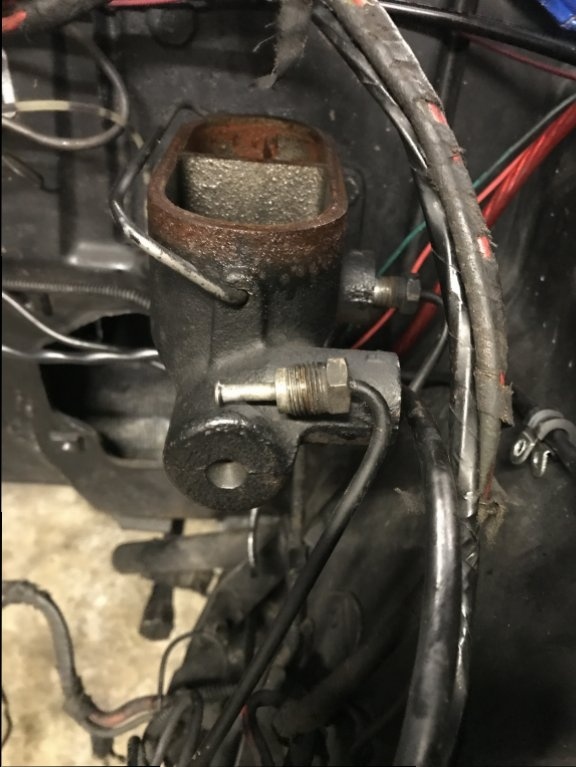

Not sure if it is just the picture but your rear resovoir in you MC appears rusty in the fluid area....Is it just picture quality?

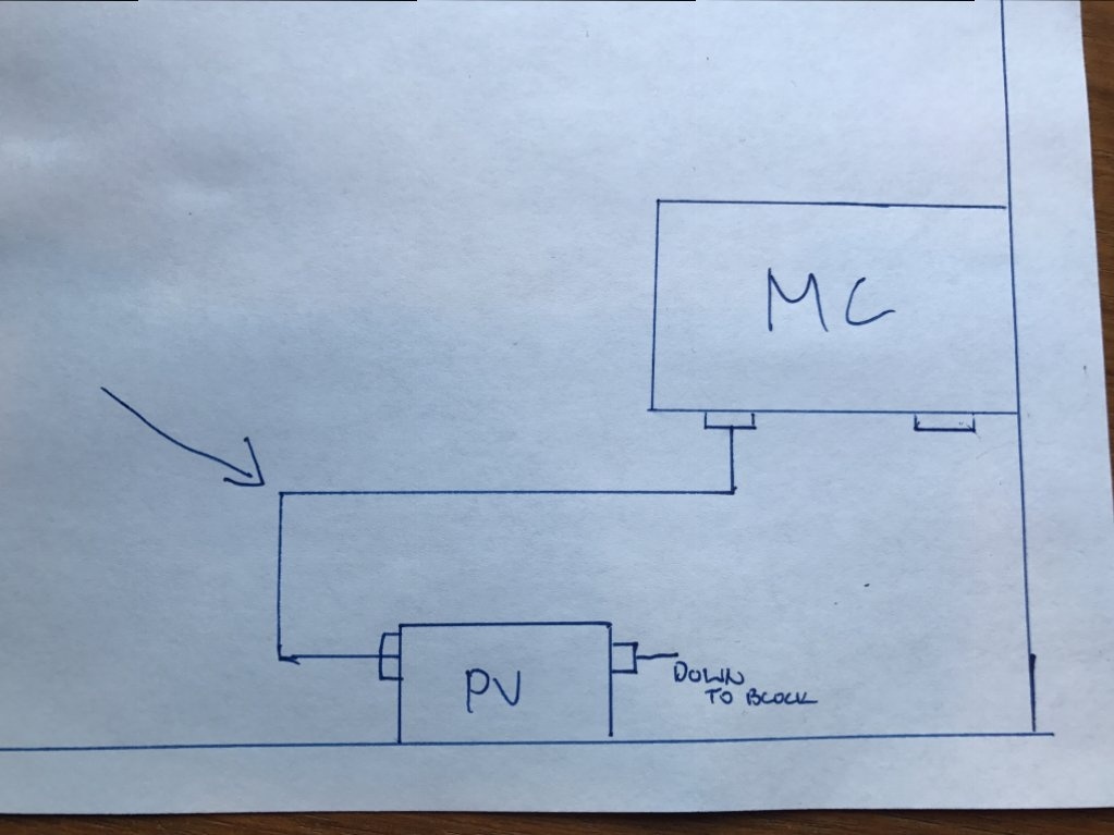

How tight can I make a u bend and still have the line function? My line needs to make a 90 coming out of the MC, go a few inches then make a U turn towards the drives side to enter the proportioning valve.
For those visual learners out here. Here is a drawing. In need to mount it this way because that is all the reach my stock line ,that used to go from the MC down to the block, has.

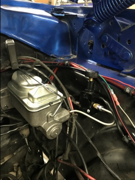

Thanks for the help everyone. Just got the new MC installed (bench bled first) as well as the proportioning valve. I'm going to clean up some of the wire stuff later but here it is.
