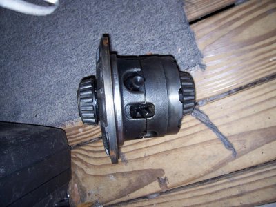

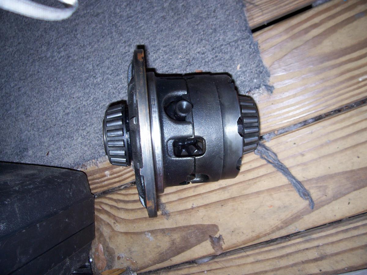

sure grip
there's no shortage of sure grips,not here anyway.It' s a money shortage.A local guy here has 2 or 3 clutch type with no gears from 275-350.just sayin :angel1:
I have been running a spool for about 6 or so years and have no problems. I have ET streets on the car and they make no noise when I turn. The corners of the tires are starting to round off a little. I keep more air in the tire for just cruising. The one thing I hate is the tire does stretch when you turn and mine will rub the outter wheelwell if i am not careful. The wet weather is another thing, not very good at all.
grip
