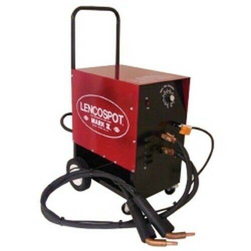

I have been searching for a spot welder to finish installing some panels. The Harbor Freight is cheap and breaks a lot. It also has too fine of a point at the weld. I have considered flattening out the tips a bit to give a 5/16 inch spot weld. I am only going to use this for this one project. The decent two sided welders are very pricey for a single project. I have looked at a used Lenco that has a ground and two "stinger" tips but it only welds from one side. I do not want to use a mig because of access issues to clean the welds. Has anyone used or made an attachment for a tig machine that works or is it a different design? I also have an old transformer, very heavy, out of an old ambulance that makes 110ac out of 12 volts dc. Lenco has a two sided spot welder accessory that is $500 if I can find an alternative to attach it to. Any ideas to keep me from spending thousands on a machine?

we had several threads on this subject , but I have two that I have had and still use one is a Lenco I have all the accessories that go with it also

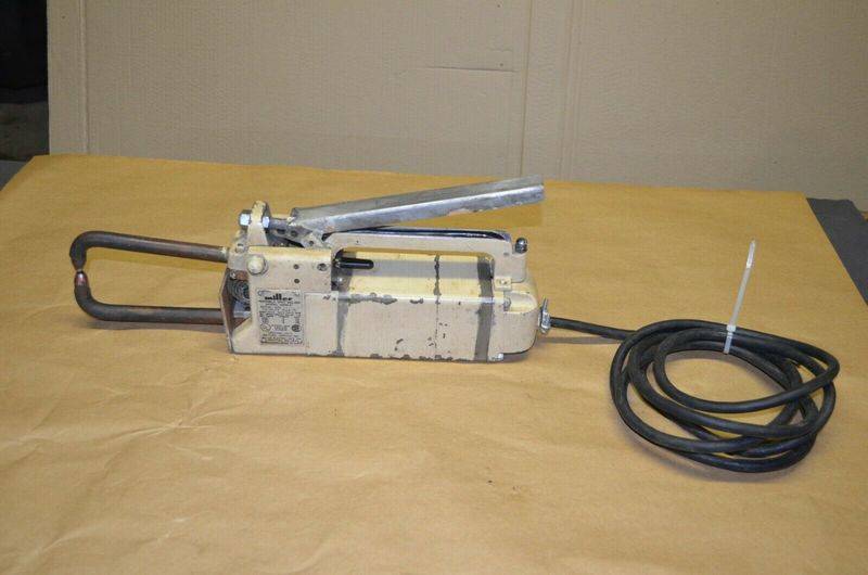

and a auto arc made by miller and have all the different tongs with it
both of these have never failed me you can find this used also plus there are other companies that make knock off`s cheap
for the Miller hand held you can also get or make a stand if need be
