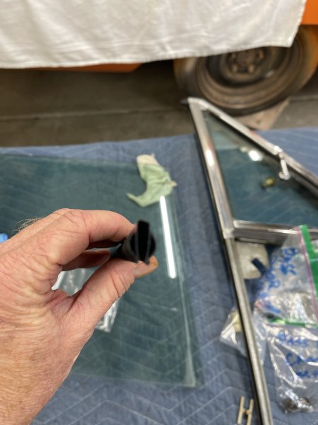

No there is not! Hopefully you have a newer one that is actually curved to match the glass contour.
Yes it’s curved. You can see the last picture ears are more flared out making for a more snug fit. I assume that goes to the bottom. The other new one is identical.

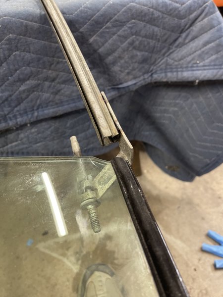

This engagement is way too tight! What’s going on here? There is no way this can fit let alone slide. It gets super stuck at 1” in I can barely pull it apart! Any ideas? It’s the plastic clips!
I am looking at the welds as a possible cause. Will grind the down a bit and see if that helps.
Yup it was the welds interfering. I ground them down. Presto…

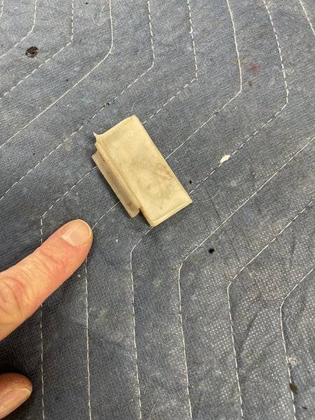

Also trying to find out where this plastic part goes still……
Another anti rattle clip.
Ok so I tried to get the glass in the other door wing channel. That one is even tighter. My wife and I could barely get it off half way pushed in. Before assembly I power wired wheeled the channel then used lacquer thinner and cleaned the channel of any debris. Before that I welded the lower mount from the outside of the channel preventing any interference with the sliding assembly. The two plastic clips of the channel liner snapped perfectly in place.
Lastly I used the correct curvature of the plastic slide.
All this AND it was too tight.
Any thoughts?
I had the same problem with my glass installation being too tight. But I used new AMD glass and pretty sure the curve of that is too much to match the curve of the channel. I had the new curved fuzzy strip btw. I determined that the plastic shoes were not helping the tightness. Without the shoes, the glass slid MUCH better. I tried grinding the shoes to give some relief. Never did much. In desperation, I used a "Chicago Screw" in place of the plastic shoe. I just happened to have the correct size on hand! Put those in and the glass is still a bit more snug than I would like but usable. They sell lots of different sizes of the screw sets so just measure what you need.
The plastic piece is shown installed in the pic. Goes just above the door release handle. Keeps water off?
