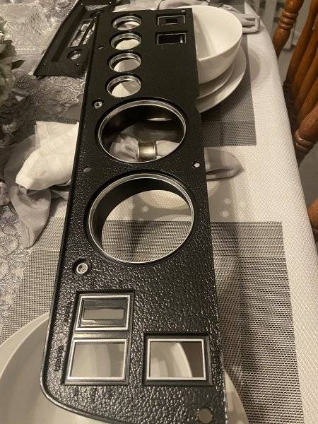

I have had very good results doing dashboards with the Molotow pens. In my opinion, they show more reflectivity than any other paint I have ever seen. I do not have the skill and patience to mask an instrument cluster to then be able to spray only the chrome areas. This is where, in my experience, the chrome pens work well, because the way that I do it I spray the entire cluster Landau black, and then I do the chrome areas with the pen freehand.

Here’s a cluster I did with the Landau black paint, Molotow chrome pen, and white paint marker for the lettering.
