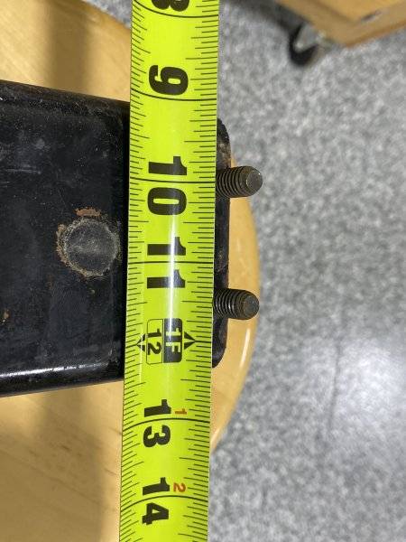

Does anyone have the bolt pattern for the front spring hanger for a 68-70 Charger? I assume 66-70 B-body should all have the same pattern..

I found the dimensions here - at least sort of as the picture resolutions is quite bad. I can read 1.5" and 1.75" distance between left and right but not how far apart upper and lower bolts are ..
@rbkt65 can you help?

Great! That confirms the 1.5" and 1.75". Missing length is 3 3/8" then. Thank you!
