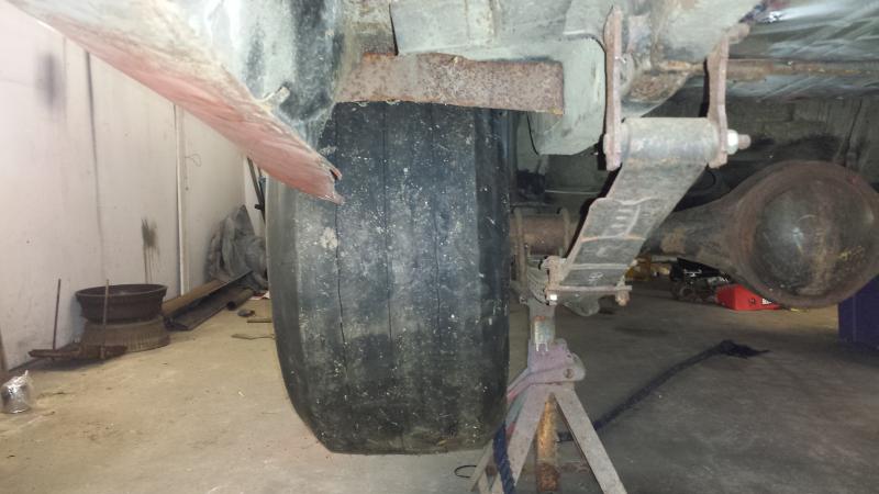

I am not certain which brand of relocation kit this is but here is a pic of my 63. The tire is 31x14. I can get some measurements if that would help you.
Thanks Greg, much appreciated. Spring centre to spring centre would a great help if you could measure it for me...no hurry:icon_pidu:

I was alone in the shop tonight so could not get center to center. From outside to outside was 39.25 inches (99.69 cm) and the springs were 2.5 inches wide (6.35 cm).
Thanks guys gives me a rough idea, should be able to fit the shortened Dana 60.

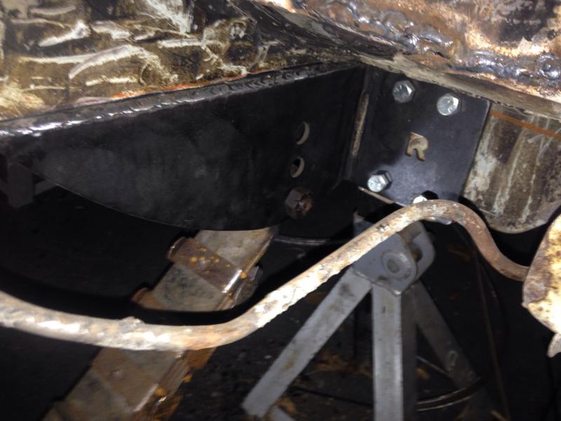

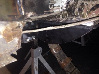

I just did my 65. Us car tool makes a kit for early b bodies now. I just bought the front hangers. These bolt in then you line them up true and weld.
Takes a lot of guess work out.
Hopefully these are turned correctly
I was looking at US Car Tool... it shows a 62-65 Dodge kit, and it states they have a different kit for the Plymouths, but the Plymouth kit is 66 and up. What would be different about the Plymouth kit? I like the US Car Tool kit a little better, even though it's a bit more than the Mopar Perf kit, which states it fits 65 Dodge and 63-65 Plymouth Belvedere/Savoy/Satellite (and up).
The mp kit doesn't have the holes drilled. So it's a bit more universal.
Us car tool does have an early Plymouth kit. You have to call them
Dodge and Plymouth have different wheel bases so the holes us car tool drills are in different spots between Plymouth and dodge
The us car tool kits are also thicker steel.

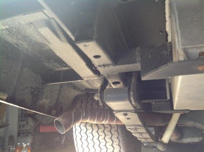

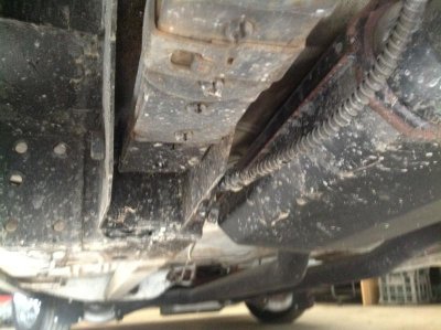

This is my 65. I think the relocation kit came from Mancini. Moved the springs into the frame rails.
I know the is an old tread but I’m doing the same relocation in my 65 Belvedere and I see tail pipes are pretty snug between spring and gas tanks what size pipe are you using on this aplicación thanks and happy holidays
2 1/2" will work if memory serves correct according to TTI exhaust. I have recently been told and have seen pictures of 3" TTI tail pipe sections used with stock gas tanks and relocated springs/ mini tubs. Some clearance issues where addressed including bending of the gas tank flange and shimming the hangers. I'm going to try to use the 3" tail pipe sections myself, hope it works.
2 1/2" will work if memory serves correct according to TTI exhaust. I have recently been told and have seen pictures of 3" TTI tail pipe sections used with stock gas tanks and relocated springs/ mini tubs. Some clearance issues where addressed including bending of the gas tank flange and shimming the hangers. I'm going to try to use the 3" tail pipe sections myself, hope to works.
