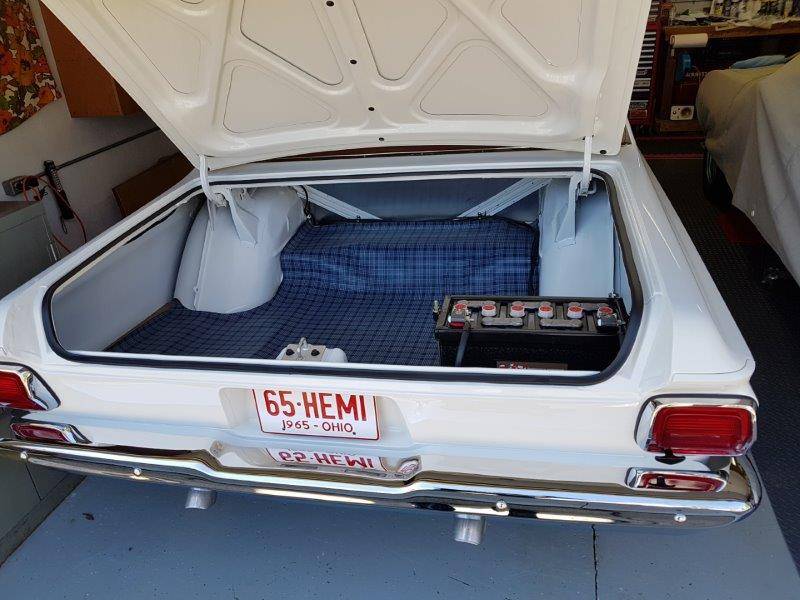

I know the is an old tread but I’m doing the same relocation in my 65 Belvedere and I see tail pipes are pretty snug between spring and gas tanks what size pipe are you using on this aplicación thanks and happy holidays
I used 3'' TTI exhaust. Yes, its snug but can be made to fit.
Which relocating kit you use and what size tire were you able to fit
On my 64 Dodge Polara i used US car tool relocation and mini tubs. That moves anything over to the edge of the frame . I have 30x14.5 (section width) cheater slicks which leaves about 5/8" from tire to tub and 1/2" tire to quarter on a 15x10 wheel with 3 3/4" back space. Rear is narrowed a little.
