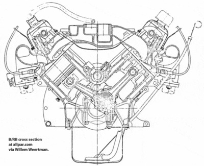

Lack of adequate oil supply & heat/friction is what causes a spun bearing 99% of the time, it causes the bearing to grab the crank & spin inside the cap... it could have been multiple factors of, rough surface on the crankshaft journal, too much radius ground in the crank with out having the bearing tapered/beveled to match, bearing installed incorrectly or bearing cap over torqued or torqued in the wrong sequence or tightening one side too much before the other, bearing cap out of round, engine needed to be line bored before the assembly started etc., not enough oil supply, wrong kind of oil, debris in the oil, not enough bearing clearances or wrong size/style bearings {possibly a cam bearing, installed incorrectly or blocking off an oil supply passage ??}, oil pump pick up starving/sucking air or partially clogged/blocks, maybe a dent in the oil pan under the oil pump pick up, oil pump bad bad.... allot of way it could have happened, but it comes down to not enough oil supply or inadequate clearances 99% of the time.... I was looking for a photo that shows the path the oil travels thru a BB Mopar I couldn't find it, maybe a Google search you can find it or our resident Professional Engine Builder Mopar Expert Jim IQ52 had posted one on Mopar Muscle a long time ago now... sorry I couldn't help more...
