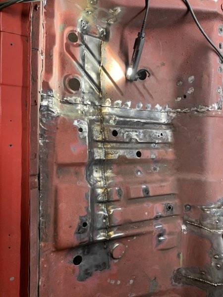

Finishing up the rework of the passenger pan and just about done filling all the random holes drilled all over:

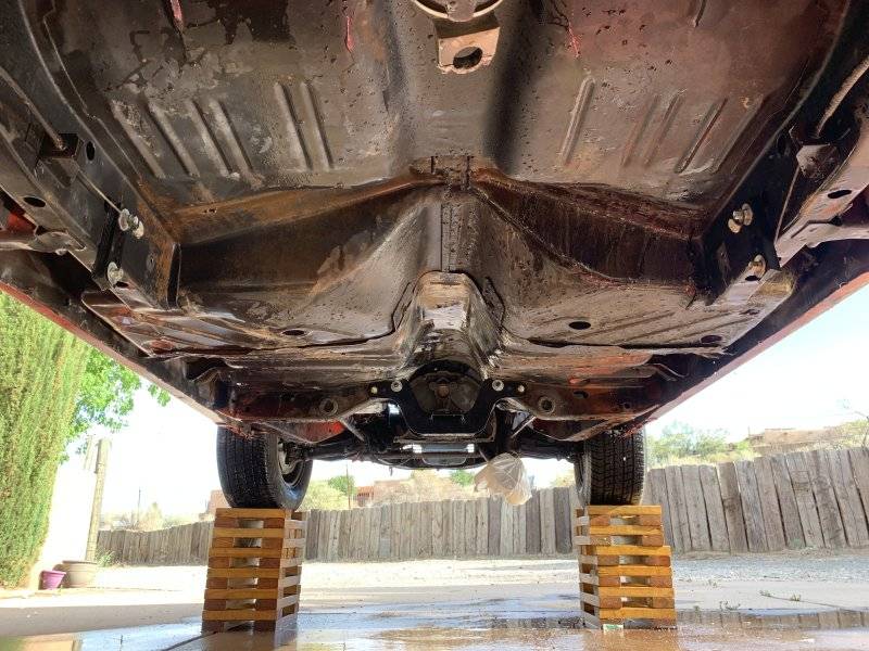

Next up was dropping the gas tank to assess the condition of the trunk pan (which was perfect), and then a heavy oven cleaner and pressure washer treatment to prepare for subframe connectors and torque boxes:

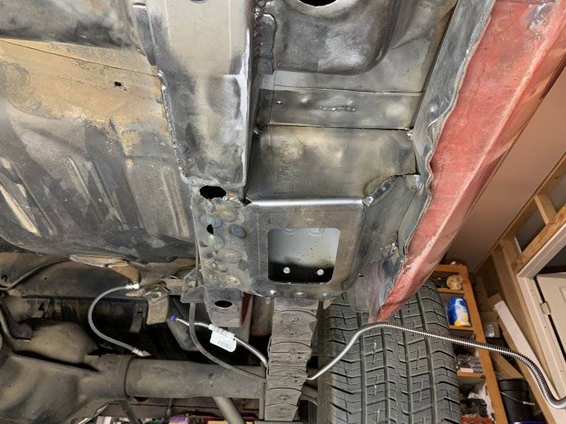

Cleaning up the torque box area and checking for initial fitment:

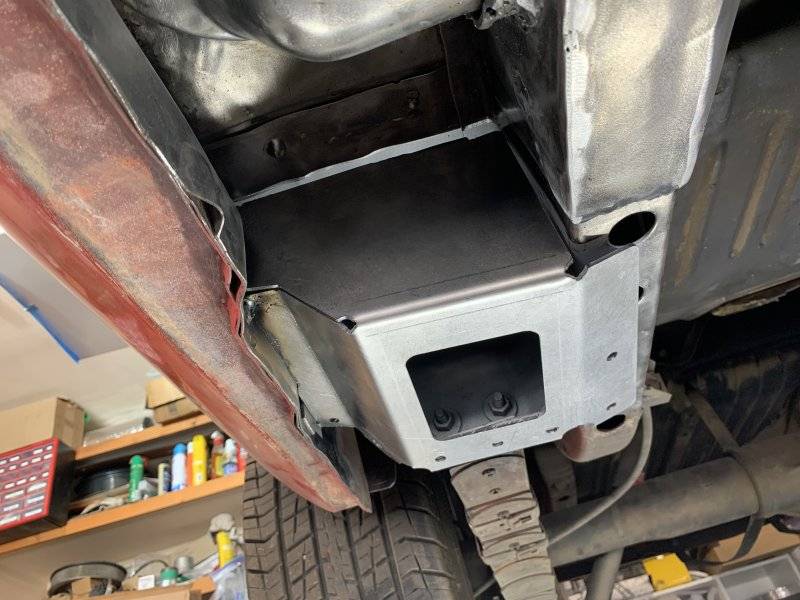

Zinc primed and ready to burn:

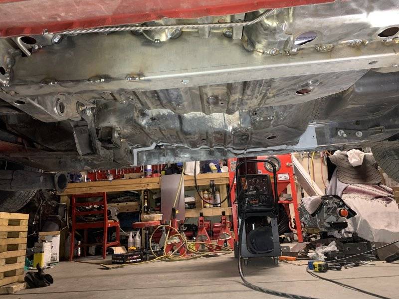

Lots and lots of welding in this post. Photos are pretty self explanatory.
