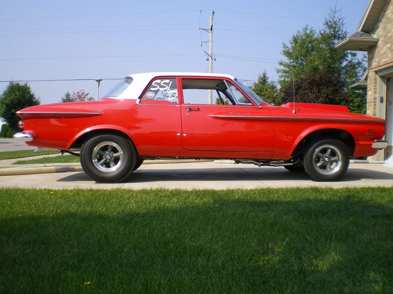

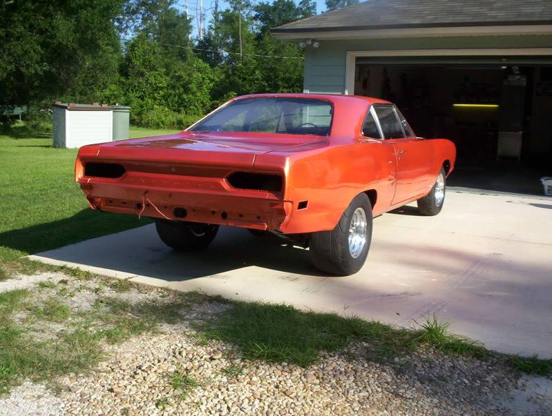

3400lb SS springs with front lowered slightly and running 60/40 shocks.

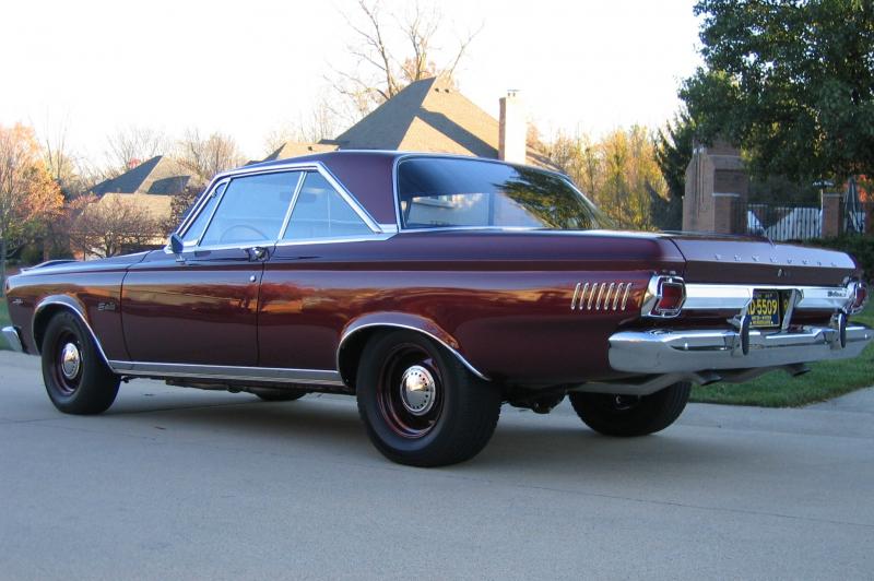

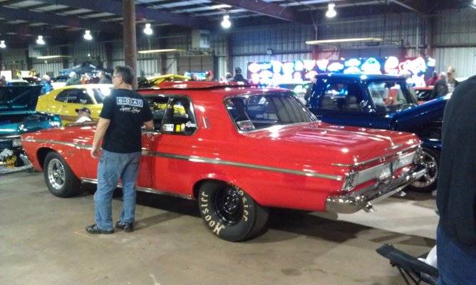

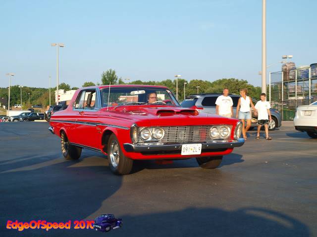

Sorry no pictures(car is apart) but 3400 lbs on a 65 Belvedere I. If you are going to have Full Dress, Radio ,Heater,Interior,Spare/Jack etc. You should be ok with the 3800's

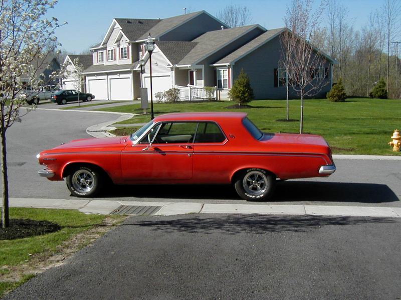

3400's

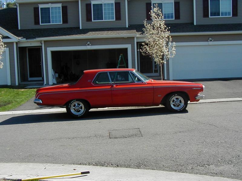

I bought my 3400 lb SS springs from Mancini. Ron

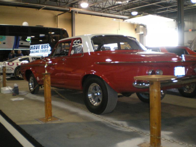

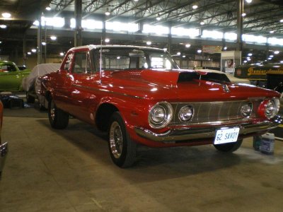

3400# springs
62Savoy that front shot of your car really looks good. I see you did an indoor car show also. :hello2: Ron

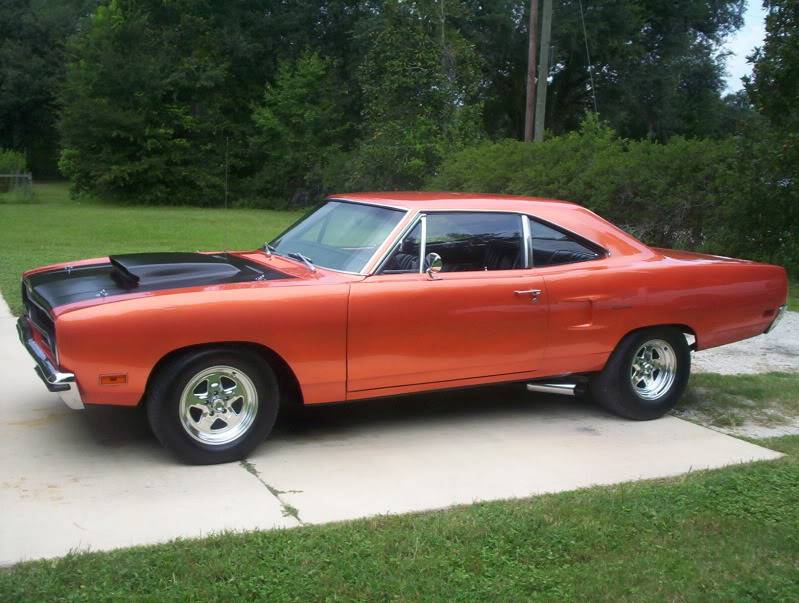

Remember the early year Belvederes use A body springs.... and A body shackles .. I bought the same ones as 383man... from mancini racing...
i kinda like the stance best after seeing all the pics of the 3800 lb springs but you all have very nice rides.
I agree the 3800's have a cool stance. I do have a new set kicking around.....
