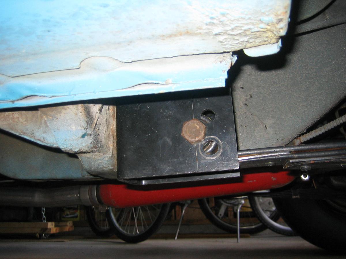

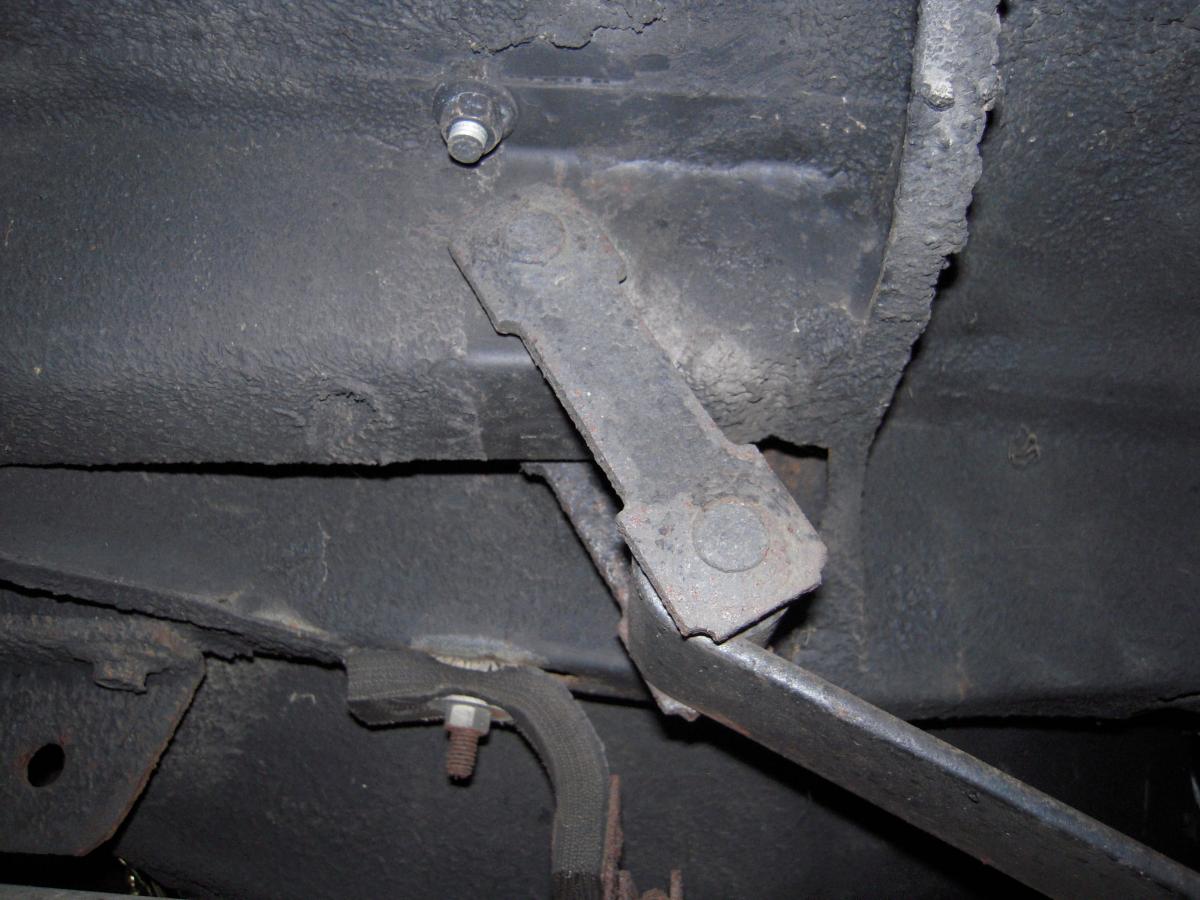

I put mine up on jack stands today. With 8 3/4 and without long shocks here's the shackle position with the rear hanging free with rims and tires on axle
edit: Using top hole in front hangers

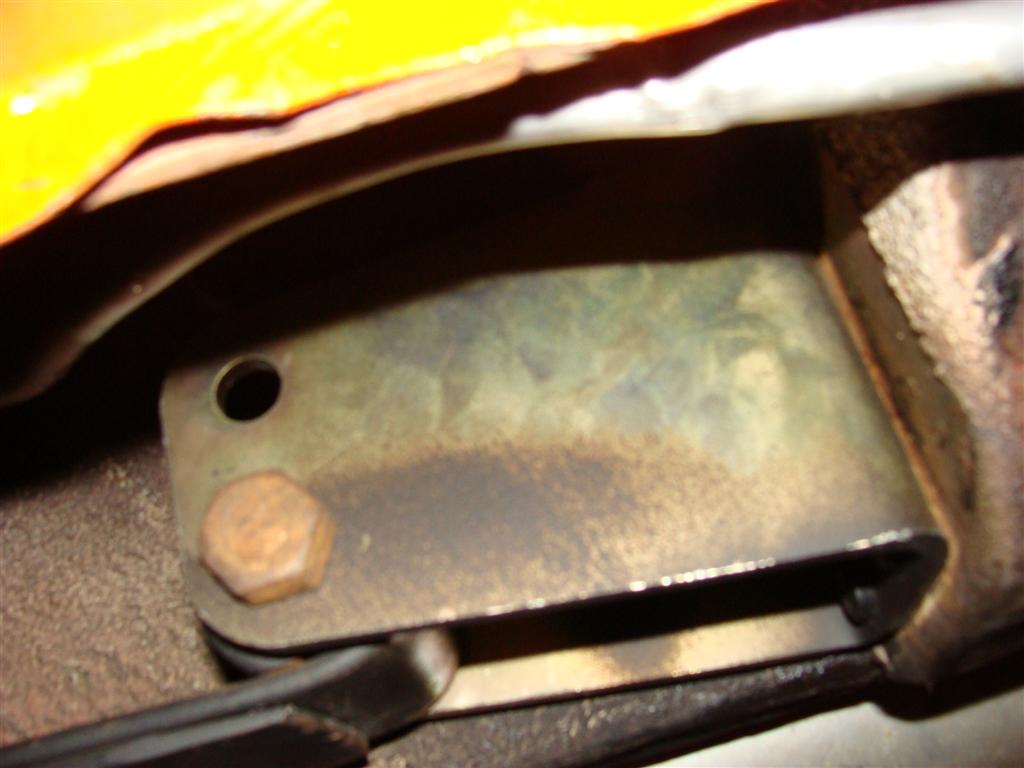

I have the exact same springs and possibly the same front hangers installed on my 66 Bel and I had to re drill the front hanger so the axle remained in the same position. With the holes provided it was either too far forward or too far to the rear.
Here's a pic of what I had to do. The two front holes are the ones I put in.

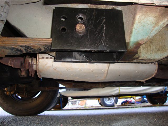

Meep -I had to do the same thing, but mine were only off 3/4". So I just drilled one hole 3/4" forward of the originals in the middle of them - since it was so close. Using the original holes, my driveshaft had no endplay in it and vibrated badly.

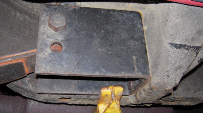

my 66 does the same thing with the 457 and 456 3400 # springs

I know for sure the shocks are holding it up when it's hanging, but not enough to stop it from rising during acceleration. I'll see if mine locks forward when I take off the shocks very soon.
What I never realized was you lost the 2" of rear segment length on the 66- on cars. Probably to get more rise out of the cars with the hanger closer to vertical angle on acceleration.
Something I just noticed in the photo I posted above. It looks like you can see where the rear hanger was stock with the rear hanging down when they put it on the lift and undercoated it..probably at the dealer.
Appearance wise..
-Mine are a bit below frame level and look like Meep-Meep's install. Only his appear to be longer. ( see below photos and measurement )
-On the 64" they look like they mount a lot lower than on the 66-> cars.
-Daredevil looks like he's got some original old school +2" hangers or something. They aren't flat on the bottom. I bought mine back in 89-90 and they look like Meep Meeps

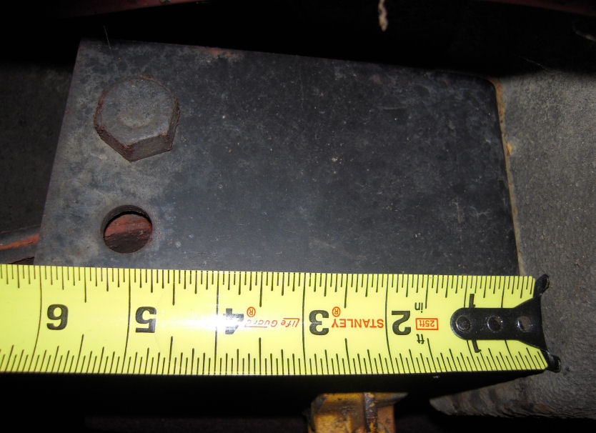

I just went and measured the length of the hanger because it appears in the photos some are different lengths.

Yeah, the SS springs as I always understood it are A body length so that would explain the longer front hanger required for the B body install. I just thought it was strange why I had to drill the holes to put it right but since that was an easy fix I didn't care. I'll post a measurement of my install just for reference.
