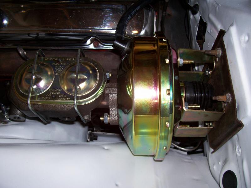

Got a setup from the ramman. Includes all the goodies and a lifetime warranty... Thanks guys
Here it is.

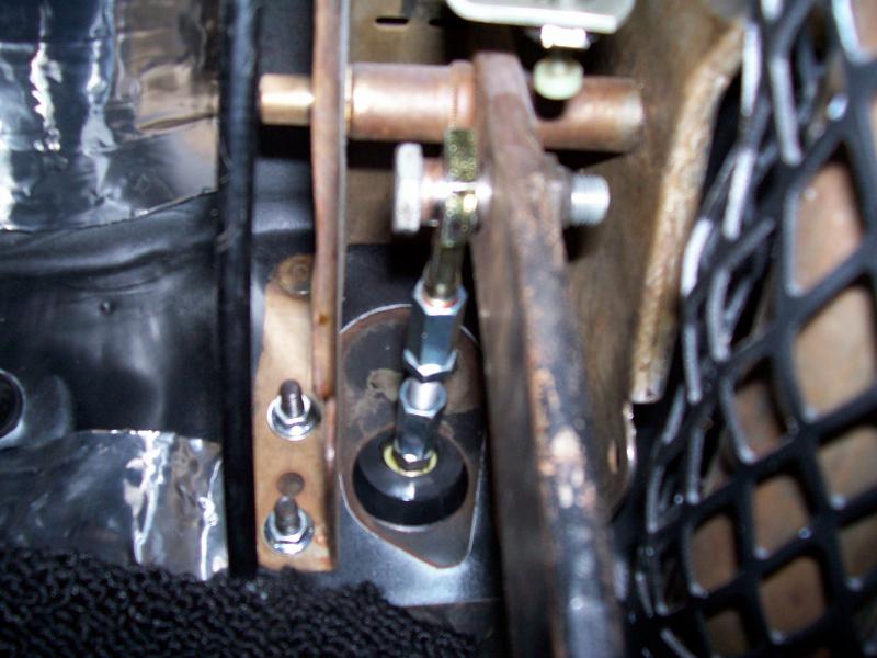

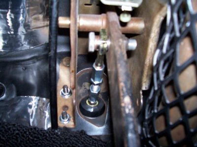

Here is another from inside. The rod isn't exactly centered in the original manual drum backing plate. This is the best I could get it, but it should work. The angle of the rod form the booster to the pedal isn't too bad.

What happened to ring of the rod, did you really cut it????? :worry:
It looks extremely dangerous!!!!
The cast iron brake cylinder will start to rust pretty soon, I painted mine before installation.
