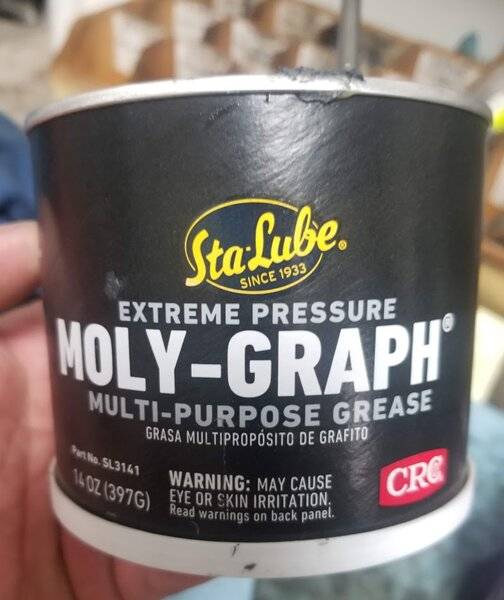

I contacted BrewersPerfomance on the question of what to use for the front end of my trunnion driveshaft as far as the right grease to use and they recommended Sta-Lube SL3141 Moly Graph Extreme Pressure Multi-purpose Grease saying that is what they use.
So I just wanted to pass on this information to all those who might be wondering just what to use for both the u-joints and the front portion of the shaft on the trunnion driveshaft.
Always follow the FSM as how to use it.
"DO NOT FILL THE RUBBER BOOT WITH THIS OR ANY GREASE!"
This is the photo that he sent to me with his answer.
I hope that this might answer someone else's question when confronted with just what is the best to use.
I used Sta-lube CV joint grease in a large tube like toothpaste. Been working great for 12 years and 40,000 miles.
the FSM says to be sure to put equal parts in each side of the trunion housing. And don’t over fill it.
