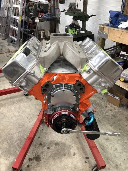

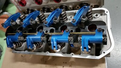

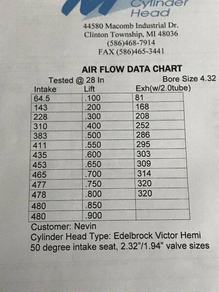

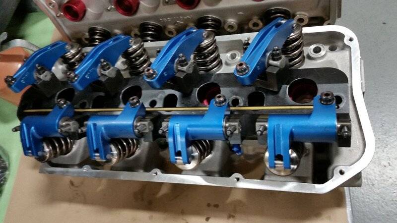

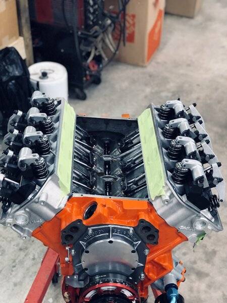

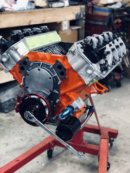

Colleting parts to build a 12:1 572 Hemi in a N/A street/strip deal. Going into a 3400#car. Which head best fits the combo to produce 850-900hp? Dont know the port volumes, but the replacement head flows just over [email protected] and the Custom head flow just under [email protected] and about [email protected]". 727/8" 5500
