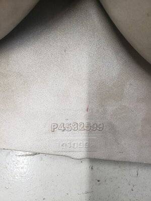

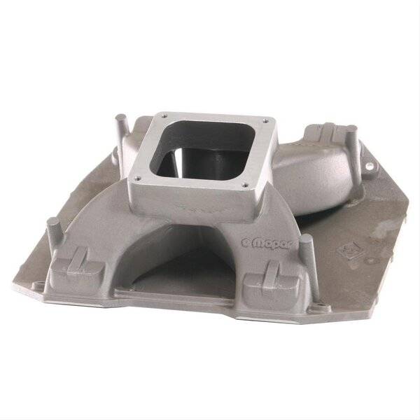

The two MP stage 6 intake part numbers(the number in the catalog and on the box......not to be confused with the number cast/etched onto the manifold) are:
P4876128 for a 4150 carb
P4876129 for a 4500 carb

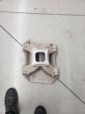

After doing a little digging, it appears as though the part number P4876129 intake would have the number “P4532758” on the manifold itself.
The P4876128 has number “P4532757” on it.
Thanks. I will probably have to go the spacer route as I figure those intakes may be a little tough to find.
