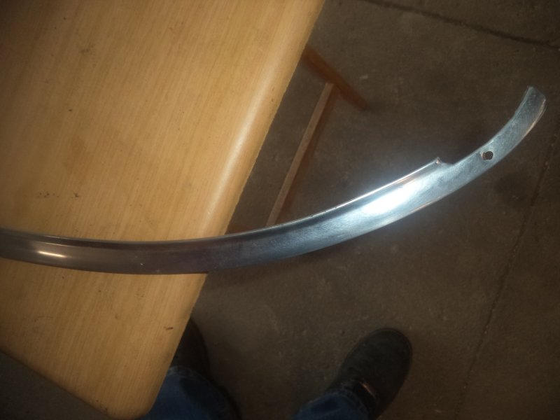

I have a nice set of windshield trim for a 69 Charger except for someone didn't want to buy new clips (I think) and just drilled a hole in each side of the bottom piece. Can this be repaired ?
Yep, stainless filler rod with TIG, grind.. sand and polish. Did just that to my rear glass trim on the Bee. You'd never know there was ever a hole...

Most likely. But what will it cost? Might look for another used one or repo parts.
Like Dadsbee said, yes. Anything can be fixed! Anyone who is proficient at T.I.G. welding should be able to fix it with a
good amount of paitience.
