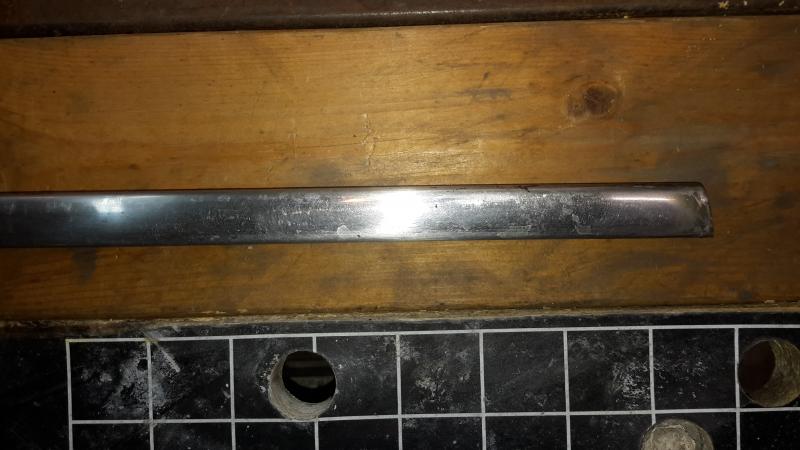

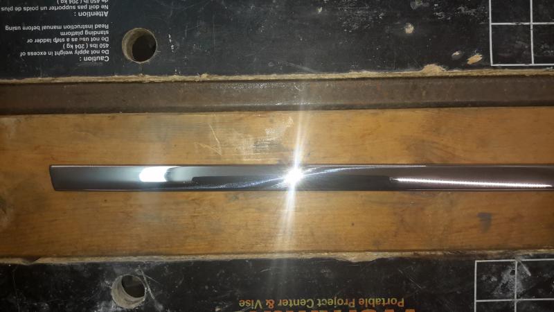

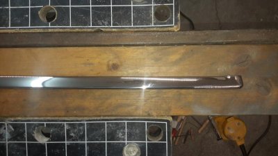

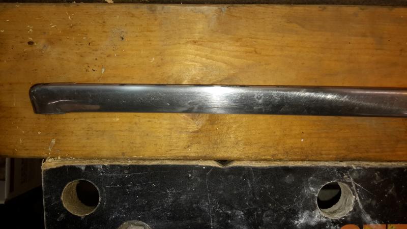

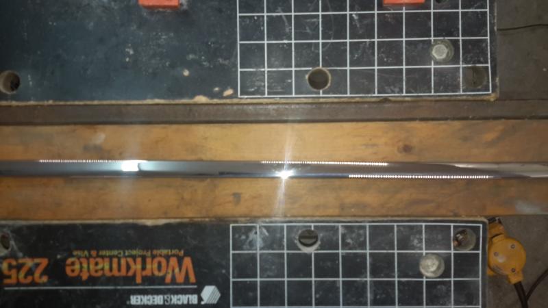

20151130_215900.jpg20151130_215910.jpg20151201_202929.jpg20151201_202936.jpg20151201_202943.jpg20151130_215900.jpg20151130_215910.jpg20151201_202929.jpg20151201_202936.jpg20151201_202943.jpg
Having never worked with stainless before,,I was nervous,,lol
I think I got it tho,,it was slow to start,,I had to do the research,,set up my shop for it,,make tools,,establish specific steps etc,,
before and after pics,,I luv this hobby :)
I did all the stainless on my hot rod and that attention to detail makes lines and paint pop!!!

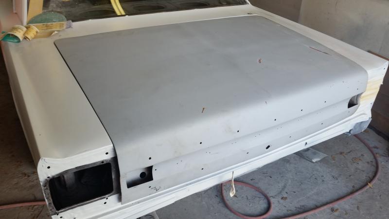

soooo,,after some more evaluation I decided to try and replace the trunk lid and hood,,,both had been hit,,and although reparable,,not wanting to refill with a boatload of bondo,,after trying to straighten,,
I got lucky and found a trunk lid local,,,took pic after a quikie test fitting20151216_131028.jpg
odds are I won't be as lucky with the hood

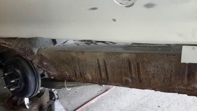

been a bit since I checked in...fenders, doors, trunk and roof are ready for final blocking

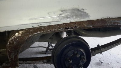

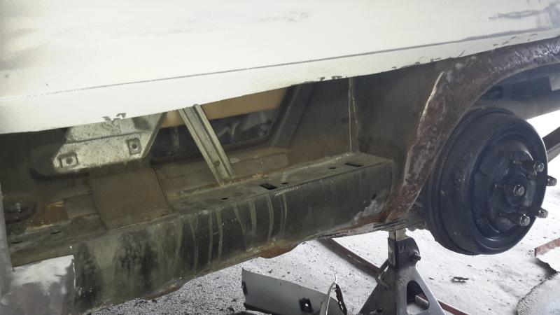

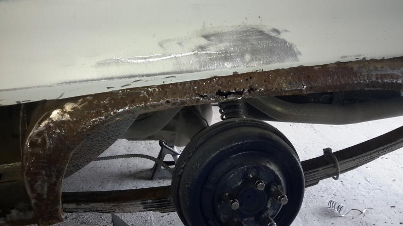

cut out driver side lower quarter yesterday,,some rust on inner as well,,oy ey,,lol
plugging along with brightwork,,,very tedious to restore stainless...
20160121_141924.jpg20160121_141857.jpg20160121_141841.jpg20160121_141924.jpg20160121_141857.jpg20160121_141841.jpg
Looks good, You need to be very careful when welding in the the wheel arch between that body line and the wheel lip. Because of the contour and heat, the panel WILL BE SUCKED IN, so go slow and pull out as you go. In the end I needed to go as far as spreading the wheel house and quarter with a port-o-power unit to get back in shape. Not sure what your using for patch panels but the Sherman panels are garbage. I tried to use them and the wheel arch contour is completely wrong and immediately noticeable. The thickness is a bit thinner than factory but not really a factor, the biggest issue is the mold is wrong. My recommendation is the AMD lower rear section (which are really good) along with cutting the arch section out of a 4 door if possible.
AMD didn't have the complétě lower that I needed. I researched the below company, they are the manufacturer. Fit seems spot on, wheel opening correct and correctly oriented. Thickness is one grade below factory
