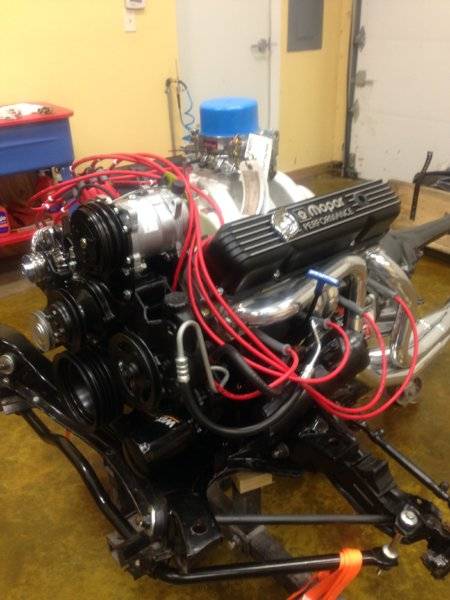

This is what we are working with.
Does your engine lose power when it gets hot? It could be that something is not happy inside the engine when it gets hot. Try a torque wrench on the crank snout when cold and then again when hot. It could also be the torque converter bushing if it is an auto. Just throwing that out there. I hope it is just the starter.
