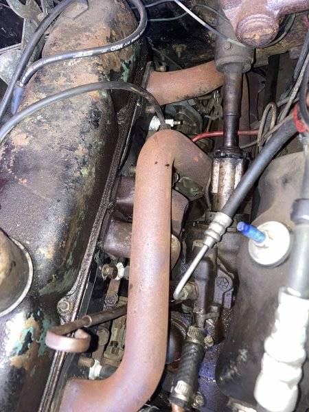

Anyone gotta tips or tricks to getting this starter out?
Im trapped in every direction I go.
Ive unbolted all the studs and from header extension, only bolt left is in front of cylinder 3 and it sprayed coolant everywhere. Should’ve known that was gonna happen.
I only have about a inch and half of play underneath before it hits torsion bar. On the top side I can’t pull it off studs because it hits steering column.
Any ideas?
Thanks! -Pat

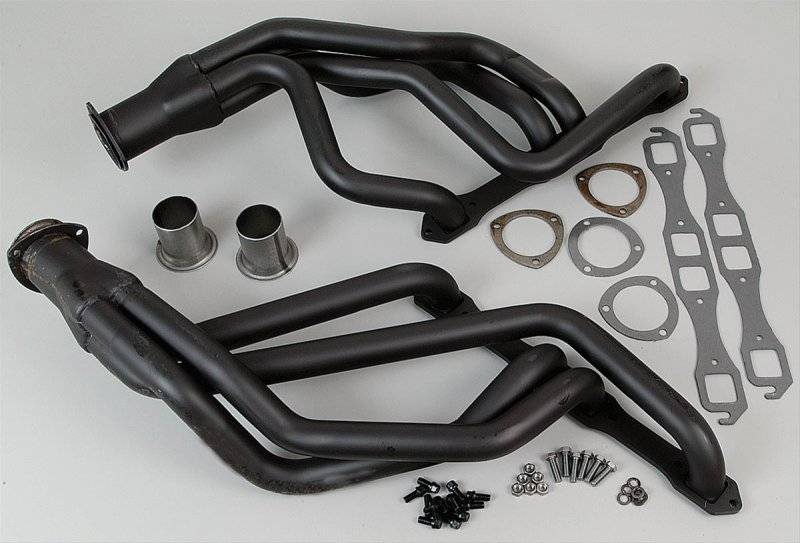

The drivers side at least looks like these summit headers:

Thats very possible! I didn’t buy these, previous owner did.
I couldn’t find a brand name on them.

Well for anyone that cares to know or is following along the post, the final results of these (Summit?) Headers, I could not remove the starter in one piece.
I disassembled it inside the header into 3 pieces.
I couldn’t install the new 440 Source mini starter either.
Tried from below, tried removing engine mount bolt and lifting.
Was trapped both times by the steering column and torsion bar.
So the next plan of attack, I knocked out the pin on drive shaft coupler and disconnected from power steering box. Unbolted steering column and pulled it back into drivers seat. With that out of the way, i was able to fit mini starter in between 1st and 4th tube. (See pic above for reference)
Hope this helps someone!
These headers are junk and are going to be replaced. They’re rusted and have been modified by a Neanderthal with a hammer.
Thanks for the suggestions, -Pat
