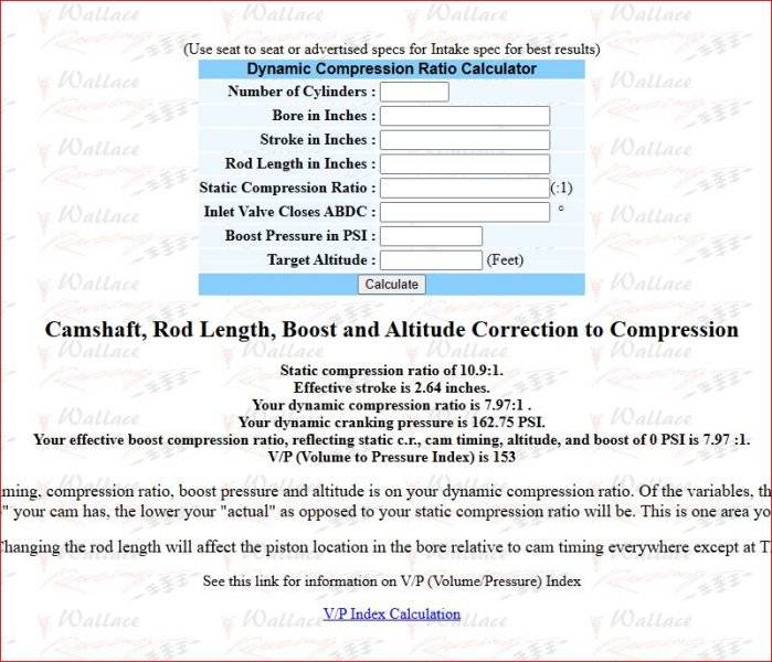

Hi, so in my research about compression ratios I have discovered all about Dynamic compression and cranking PSI. I am reading that for pump gas your dynamic compression should be around 8 to 1 and 165 psi cranking pressure for an iron headed big block. Does this sound right?
The camshaft I want to use in the build has a 74 ABDC. To get the 8 to 1 dynamic ratio I will need a 10.9 static ratio.
Is 10.9 static and 8 dynamic still ok for pump gas?
I plan to use Edelbrock 84cc RPM heads or 915 heads to get close to the 10.9 ratio. Wallace.JPG
Will advancing the cam change these ratios?
If I plan to install the camshaft 4 degrees advanced, should I be recalculating the static compression at 70 ABDC so then bringing the static compression down to 10.5 to 1.

Forget about DCR. It is meaningless for determining the use of pump gas because the DCR doers not take into account things such as port flow, which among other things, controls how much air is drawn into the cyl.
Adv/ret the cam makes a difference. I would advance the cam 4*. It will make a small difference; whether that is enough for you depends.....

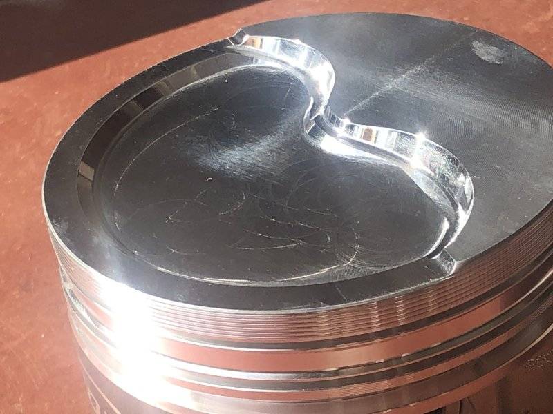

The thicker head gaskets changed my compression ratio from 10.9 to 10.1 and the knocking stopped. There was no quench but at least the knocking had stopped. I had a cam go bad so I took that as an excuse to pull the engine and do it right. I changed to quench style dished pistons....
I'm at 9.8 to 1 with quench and have driven in 110 degree heat with no detonation.

Furthermore, there are at least 3 different calcs available out there to use and they will give different results. Which to use? Seat timing? 0.050” timing, some modification of those. Does cylinder pressures really not start until the intake valve touches the seat? Why is 0.075” inch valve lift a magical number?
I hate to leave cylinder pressure on the table. I have used these calculators and adjusted for variables and have become comfortable with blending it all together and making a choice for my stuff, understanding that I’m okay if I get it wrong.
My suggestion is to get someone with experience to do this for you, understanding that they will be conservative.

I calculate and look at DCR, and then calculate cranking compression ratio, but only to see it the compression ratio is way off. I select the cam I want to use, and use the DCR to figure the compression ratio I want, not the other way around.
