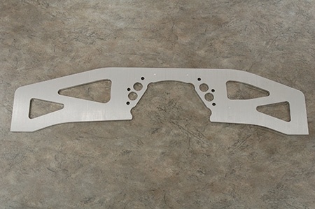

Eventually you'll change to one of these. It's much better...

I did have issues with the Moroso mounts not keeping the engine properly aligned straight.
Put the motor plate in continued to use the poly mount and issue resolved.
New car had motor and mid plate. PITA to remove and install headers, starter but NOTHING moves around with that setup. Also poly trans mount with no issues.
Heard there is also some physics involved when you run motor and mid plates that helps the car 60 foot harder etc etc not sure could be ls wise tail
