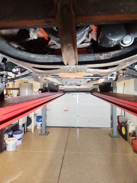

This does not look right. The center link is higher at the idler arm. This car has a Borgeson steering box on it. Looks to me like something is a miss.
Most common fault I've found is the idler arm bracket being mounted incorrectly. You can remove the idler arm. Place a long bar through the holes. Heat the bracket and bend it until the center link is level. It's actually quite easy. Haven't heard of any issue with the new style box being in the wrong location.

The car has pretty bad "bump steer". Cant stay this way. I checked the numbers on the Pitman arm, it is a Proforged standard ratio arm. It is to be used with a standard ratio idler. Different Proforged part number for a fast ratio arm and they suggest the fast ratio idler part number to go with it. So I dont think the arms are wrong.
That idler bracket would be a bear to bend in one piece. I might cut the bottom half off, bend the top half out where it needs to be, then weld the bottom half back on.
If you have a digital level you could put it on the output shaft of the steering box and compare it to the output shaft on the idler arm.
Its worth noting that neither of those has a balljoint on the end so you would have had issues getting the center link on if one or the other was out of kilter. As well you would feel a bind in the steering OR you would see some unusual movement at either the steering box or the idler arm. when you turn the wheel.

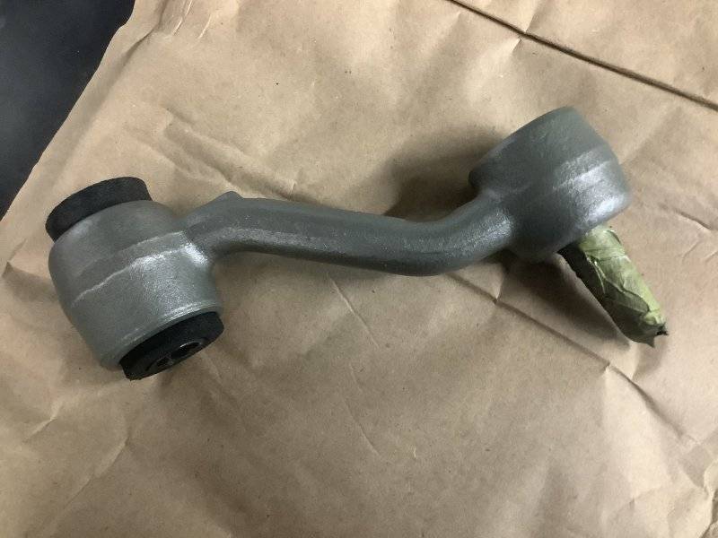

Most of the new reproduction pitman arms seem to be bent a bit different than the originals. I had the same problem as you. I ended up finding some older USA made pitman arms on Ebay, and that solved my issue.
Yeah, was concerned about getting china stuff; mobileparts said he has a USA supplier so went with him. Have to wonder given Black-Sheep's post above, if there wasn't a shimming need, but glad to say new pitman got the results. So far so good anyway..
