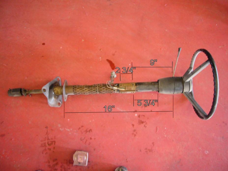

I think an A-body column will bolt in with the mounting bracket from the B-body (the brackets are different, but the 4 holes in the column are the same on both cars. The only thing I'm not sure of is once it passes through the firewall...
Here is a pic with measurements from my brother in laws A-body column.
These measurements are rough, not exact...
All matched what I measured on my Coronet except the 16" measurement was 17 1/2" on the Coronet, but the plate has room to slide... So it will bolt up to the dash, with the steering wheel in the correct location, but now I need to verify that there is enough length left after it goes through the firewall.
That's great info. Thanks for posting.
I just looked at the pic again, and the 16" measurement is not in the right position, I believe I measured that from firewall mounting plate to mounting holes, I'll double check and update the pic...
The pic is of the A-body column by the way if I didn't say that earlier...
