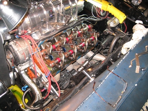

I'm told there is just a pin that needs to be banged out and then it can be removed easily ..manual steering ..need to order kit ..anything else here I need to know about removal
No column or box has not been removed ..didn't know ..do I just remove the the column at the dash to make room to remove coupler
If it's not OEM correct and a modified car,you might concider the Flaming River joint,,,,,
