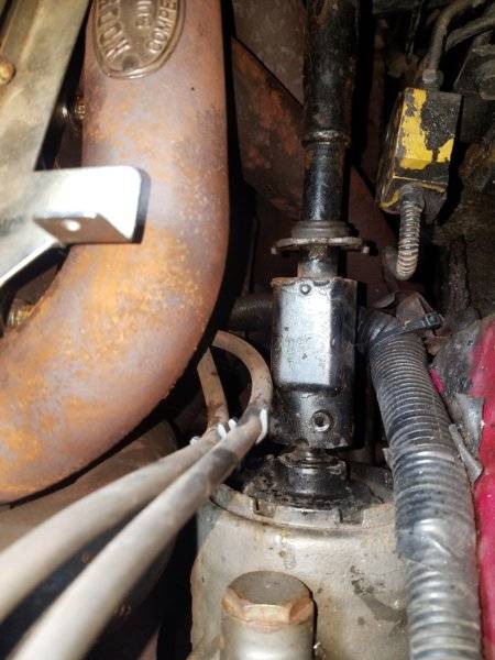

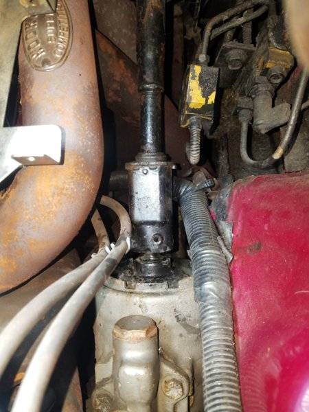

Apparently, I'm missing the metal bracket thing on my steering coupler. The rubber boot keeps sliding up the shaft. Is this going to be an issue? Can I just wrap some electrical tape to keep it from sliding up?
Here's some pictures of what I'm talking about

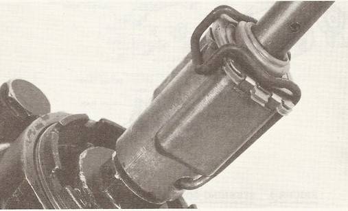

Zip-tie might work better than tape until you can get it fixed properly.

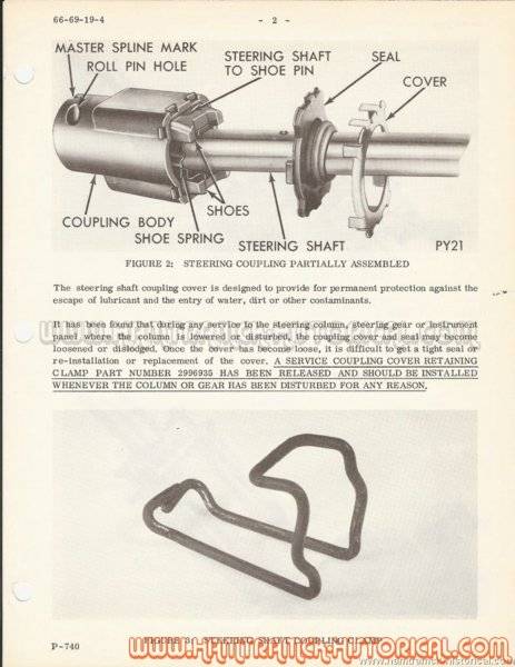

You could use one of these before and after you get the rebuild kit. Just Google "Mopar Steering Coupler Clip"
Do I need to rebuild or replace the coupler or just put the clip on and all's good?
Ma sez "if you disturb, put on this here clamp!" :thumbsup:
If you’re that close and you don’t know when or if at all it’s been rebuilt, I’d do it! Kits are not that expensive and I would definitely get a clip as pictured above for the final piece. I just did this last winter and wasn’t bad at all. I will say, that retaining clip can be a real pain to get on! It’s tight!

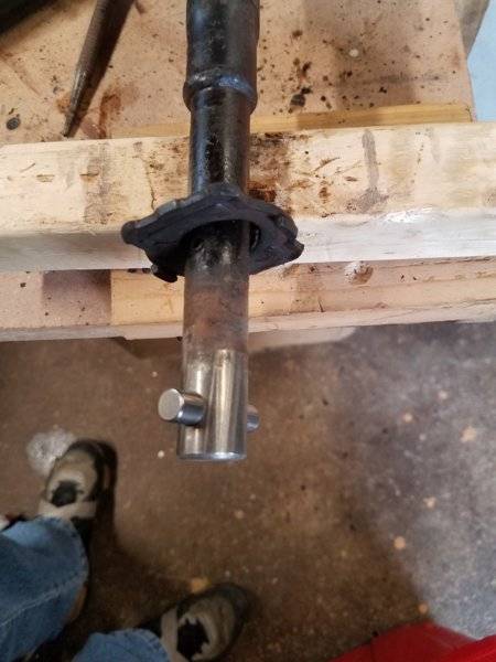

First of all, thanks for the replies and help. After some rather choice words, I got the steering column out and coupler off. Got the internals and case soaking. That grease in there was almost hard.
Is this pin supposed to come out?
I didn't want to beat on it, but it doesn't seem like it wants to come out. I looked in the FSM and I didn't see anything about it coming out. It's possible I overlooked it.
Yes, that pin comes out and you'll want to reuse it as the rebuild kit pins are ****!
Is this pin supposed to come out? View attachment 715574
I wouldn't take the pin out if it's in good shape. The seal and metal cover will slip over it. The one I had, the pin was really in there tight and I was afraid to screw it up trying to remove it.
