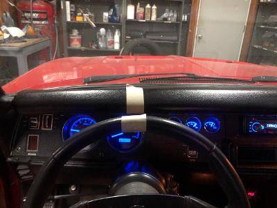

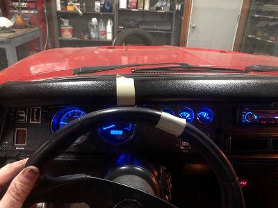

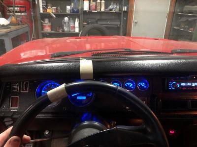

Uhhh, No again. I had a Firm Feel unit in my Charger and with less than 14,000 miles on it, there was no adjustment left to it.....it still had that terrible slop in the center of travel. It didn't leak but the slop was terrible. Look at the photos below to see how much slop was evident with the engine running.
Is this acceptable to you? This is free play before the tires actually start to respond.
