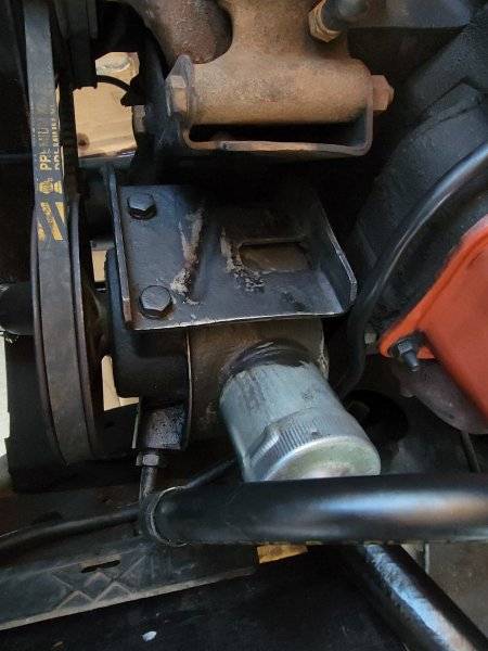

Hey guys my steering pump is leaking, and it looks like it's from the reservoir to pully area, I saw some gaskets i can get, and I found a video on YouTube on a guy doing that o ring swap but he didn't show any of it only the after its on... so I was wondering how easy is it to do ? Or should I just get a new pump if so how easy is that to put on as well... I have a '64 361 v8 thanks for the advice..

It's leaking from here at the bottom thou.though.. and how do I know if I have a federal pump or a trw or does that not matter when getting the gasket kit... and what are the steps to achieve this task ? Do i need special tools ?
Snap a pic of the pump and post it here.
Looks like a TRW. Are the hoses easy to remove and reinstall... I'll probably end up buying new sending and returning hoses also... I will also be buying a pulley remover and installer..

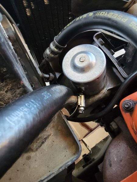

the hoses are fairly easy to change can you post a pic of the pressure hose.

clean yours off good. It probably is just leaking at the o ring where the tin can goes on. Easy to fis, but messy.
dont loose that cap, hard to find a replacement.

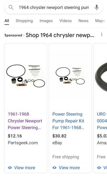

I'm sure it's just tye o ring from reservoir to pump... I can find the gasket kit, now should I change other gaskets it comes with or should I just do the o ring...

there is a flat gasket inside on the back where the bolts thread in and then the big o ring. I followed this advice on my car and it’s dry and working fine.

and the fill level is the bottom of the neck, I like it a bit lower than that, but no seeing the unit inside.
many fill them to the top of the neck and wonder why it leaks so bad. Really. Had several people dong that.
I would fix the PS leak and they say “it still leaks, and it wasn’t full either, so I topped it off”

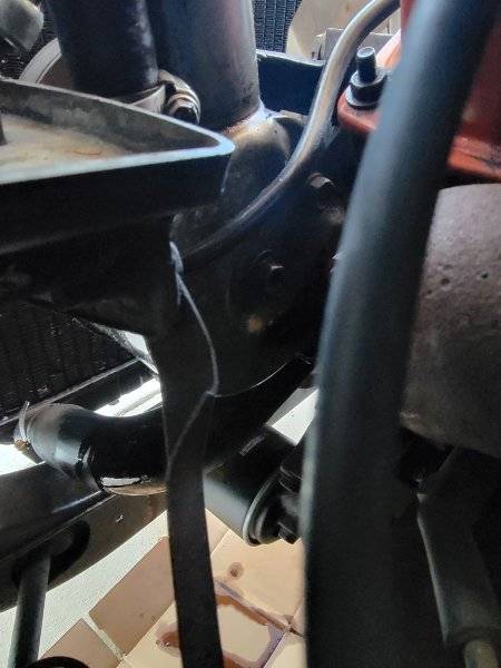

Can u give me more information on the shaft seal ? Because I think it's that and not the reservoir o ring that leaking but I'll have to take a better look tomorrow morning I'll upload some pictures...
